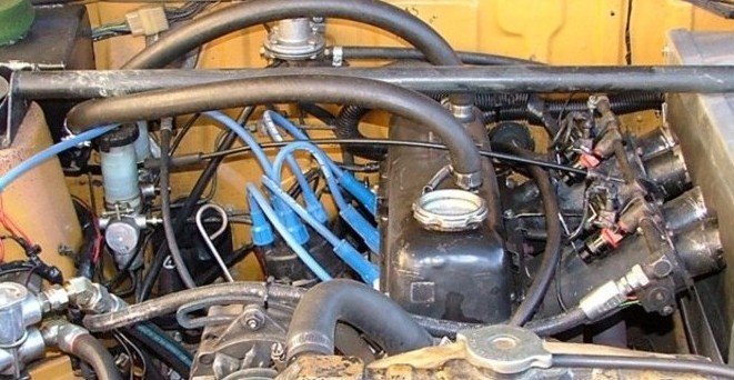

im looking at replacing my twin 40mm webers with a fuel injection system. has anybody done this?
ive seen chris petersons coupe race car and something like that would be good.
what sizes would be good for the tubes i was thinking 50mm or 48mm like a weber and what size injectors would suit a built A-15
any thoughts and prices would be awsome
thanks kurt

thanks lagwagon i saw that just after i posted this but im still looking to do it my self.so pics and stats would be good
thanks

I think that this is the setup that you were refering to.
Works well, doesn't it.

Hey there, I cant work out how to get the link here but if you type in "B310E.F.I." into the search area My set up will be there, It was cheap to set up and now turbo'd It should make some good grunt.
Cheers. Adam

yeah dodgeman and this thing was quick at the australian hillclimb championships he ended up winning the 0-1600 class in it to.
when i was talking to him he said that it was basically copyed off of a sprint car that he knew of.
just reading through the fuel injection post has anybody done the weber manifold version of fuel injection as ive already got one?
or should i go to 45mm webers?
John Taylors was on a Weber manifold and it was making 200 HP.
