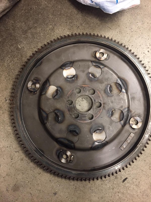

Motor is out again.
This is the second time I've toasted a crank shaft by spinning a crank pulley and Flexplate.
To hard of launches off the line. I've spun the crank pulley on the woodruff key twice and have cracked the pulley and ruined the crank and ovaled the flexplate crank bolts on the rear.
So it's time to beef things up.
My project build guy has added some material to my flexplate and has spun me out a new crank pulley with hardened steel.
A couple extra woodruff keys will be added to the crank. After that, the weakest link will be the crank shaft.
Turbo builds just don't do this but I love the launches. 😀
After a trip to the balance guy, I will be back up racing shortly.

Hey those look like good fixes. Reminded me that the A14 guys also have the pulley-cracking problem when driving a supercharger from the pulley
