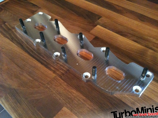

anyone adapted GTI-R ITBs to weber manifold?
2002/10/28 6:49
Posts: 10975
looks close and maybe good for boost if it fits
https://www.gspec.com/images/product/medium/7378_1_.jpg
Posted on: 2018/10/26 15:47
Re: anyone adapted GTI-R ITBs to weber manifold?
Posts: 31727
looks promising as they are only about $400
DCOE bores are on 90mm centers,
top bolts 110mm apart,
bottom bolts 70mm apart
