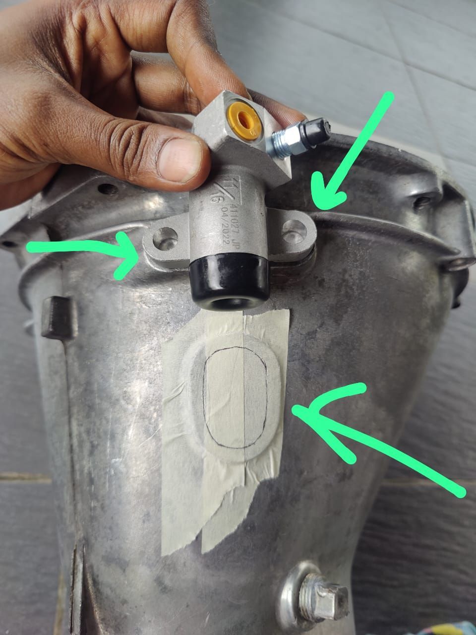

Converting
Hydraulic to Cable
For transmission equipped for Hydraulic clutch (slave cylinder), convert it to work in an RHD cable-clutch 1200.
23588.jpgAlbum 23588
  1. cut the oval out of bellhousing, it's already cast in place
  2. fit a cable clutch release arm. Throwout bearing and spring are the same, only the fork is different.
  3. fit the cable through the bellhousing and over the release arm hook
  4. Adjust the play at pedal
  5. Adjust the play at firewall
Cable to Hydraulic
For transmission equipped for cable clutch, convert it to work with a Hydraulic clutch slave cylinder.
23589.jpgAlbum 23589
  1. cut the oval out, it's already cast in place
  2. Drill and tap the holes for the Datsun slave cylinder (boss is already there). Also get the adjusting rod
    4652.jpgAlbum 4652
  3. fit a hydraulic type #clutch release arm & spring. Throwout bearing is the same, only the fork is different.
  4. Bleed the master and install (if you have a cable clutch, see RHD Hydraulic Conversion)
  5. Fit slave and hydraulic lines
  6. Bleed the slave
  7. Adjust the play at pedal
  8. Adjust the play at release arm
