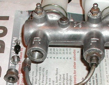

This helps rear drums work, it's not required when using disc brakes.

The rubber disc is the line pressure valve.
Its job is to keep 10LB line pressure in the system initially and then to slowly bleed back to the master. The theory is to hold the shoes to the drums against the shoe spring tension
If you leave it in after fitting discs they will hold on as its not required on a disc system........no springs.

There are 2 types of valves
Disc and drum
Drum ones look like the pic
Disc ones look almost the same but have 2 thin grooves down their lenght. This allows them to pass pressure on pedal release. They hold between 2 and 4 lb pressure which is ok for discs.

I know that this is an old thread, but i think that this is relevant.
When i was an apprentice, that rubber valve was called a "residual pressure check valve" & its purpose was to maintain a small amount of hydraulic pressure in the line at ALL times. This was to ensure that the lip of the rubber cups remained in contact with the bore of the wheel cylinder to prevent any possibiliy of air entering into the cylinder.
The pressure was nowhere near high enough to offer any real opposition to the function of the brake shoe return springs & so had no effect on brake release performance.
Thats the way it was taught to me & i have never had cause to doubt the truth of this.
Disk brake calipers have no real method of returning the piston into its bore, save the small amount of springiness in the piston seal. This will draw the piston back into the bore by a very small amount, which is exactly what we want. If the residual pressure check valve is not removed when switching to discs, this small amount of residual pressure in the line will prevent the piston in the caliper from drawing back enough to allow the pad to clear the spinning rotor, creating the drag that you are experiencing.
If you are messing with something as important as brakes, it's probably a good idea to learn all of this stuff BEFORE doing anything that can seriously endanger other road users.

The Datsun 1200 master cylinder for disc-brake models also use a check-valve. Perhaps it is for lower pressure than what the drum-brake requires.
So remove this if you know your cylinder is for drum brakes (7/8 bore), and you are fitting disc brakes. Otherwise leave it in.

I'll be more descriptive. The rubber thing with a spring on it is removed. And the rear line assembly is put back together.
You only need to do this if converting to 4 wheel disc brakes.
