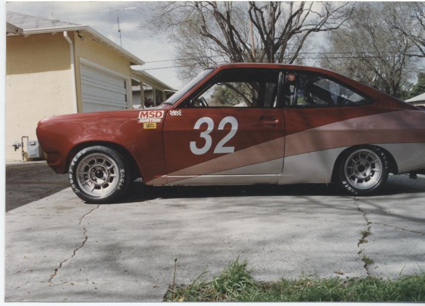

73 datsun 1200 solo2 prepaired race car

thats very cool ! how did you get the arse end so low ?

Oh yeah. You should check out his video. I recon these are 3" lowering blocks at the back aye.

rear suspension is datsun comp springs with traction bars from the comp suspension manual,
carrera shocks panhard rod , 5/8" sway bar
no lowering blocks are used. currently upgrading to three link rear with coil overs may sell current set up not sure yet
