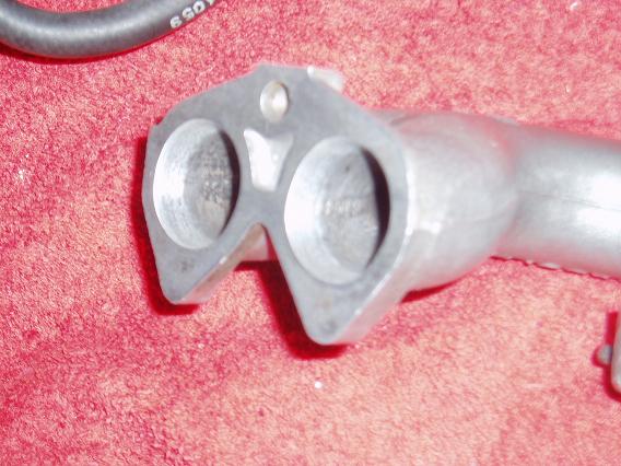

as above

what do you guys think?

Not bad...smooth - got a pic of the head you are trying to match it too?

What grit sand paper did you use to finish it ? you want to use 80.

is it just me, or has only the first 1-2cm of the manifold been done? im guessing your going to go deeper into the manifold than that

nah its not just you. ive got more work ahead of me. ive been using a triton rotary tool to grind it away and then polished with some wet and dry. is their a reason that you suggested 80 grit?

Yeah 80 grit is what you what to finish it off with.It will give you the best fuel/air anodization.
If you go to smooth the fuel will stick to the walls of the port if you go to rough it will cause to much friction giving less air flow.
Use 80 on the inlet side(ports and manifold)
Then mirror finish the exhuast ports.

k cheers m8 thanx for the tip ive been down to the garage and done a bit with 80 grit.
