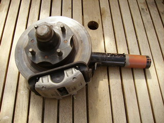

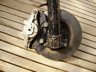

what rotors are on these etruts ?

F.S. BRAKE/STRUT UPGRADE
* 610 (180B) strut shortened to 360mm
* Girling Caliper (Commodore VK/VL/VN, similar to stock Aussie-assembled A10)
* Looks like stock 610 245mm (9.65") rotors (Same as B310/A10). But since the VL caliper is for 22mm thick rotors, perhaps these are 280ZX rotors (20 x 252mm/9.92")
