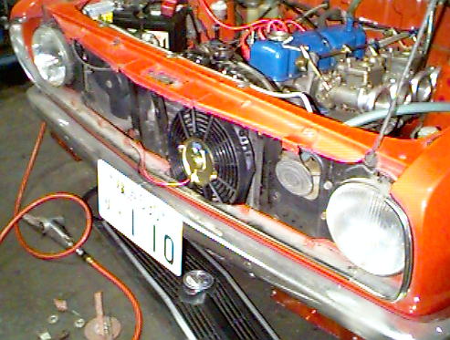

| thermo fan on front of radiator, this ones not mine its off a japaneese site |

 Re: attn: B120dat Doesn't look like a standard radiator to me. It would fit in the radiator cavity otherwise, he;s had to cut into the front panel, and the lower chrome strip..not nice.
But I guess it's a good idea if you don't have the space in the engine bay, or if you need a little extra cooling for driving in traffic.

 Re: attn: B120dat yeah this probably ist the easiest way, ill get a pic of mine tommorow i promise as a comparison

Jaime, if you do it right -- like 1200rallycar's setup -- electric fan is good.

 Re: attn: B120dat cool i got some attension  lol umm yeah cool nice, thats on a standard radiator too  , little bit of cutting but nuthing major :P big thermo fan that one  bigger the better i spose cheers rallykid
