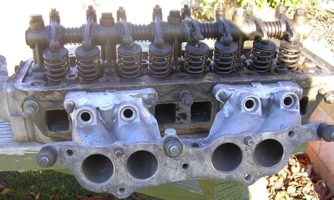

4K injection manifold welded to A-series intake manifold header.

The other half:

only 200$ on trademe!
Pretty sweet deal. Pity the k series injection runners are so rude. Thats easily fixed though

i thought it was the 7k that had injection

whats does this injection set-up come on?

I think it was fitted to last of the rear drive starlets. I knew a bloke once who had ke35 with this injection on a 4K. I can't say I've seen many of these manifolds around. You'd think that some toyota enthusiest would have had it.

5K injection had the runners that come up over the rocker cover, this is a 7k injection manifold. Or is this the one thats on the other photo but chopped up?
There were a couple on ebay last week, the 5k one went for $100, the 7k about $140.

this is only half of the manifold. The other half of runners and the throttle body/plenum come over the rocker cover ala 5k

I was trying to work out what was going on, the 7k ones are straight out the side like this which was making me think that was what it was from.

The runners on the half of that are quite long. You'd reckon that would give quite good torque characteristics. Looks a better design that the A series manifolds. You'd want to mill off the TB flange, and TIG one on for a bigger TB though.
