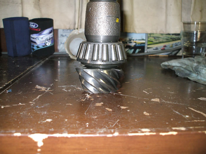

This is how it should look!

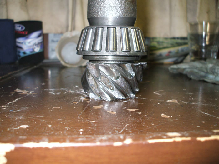

........... and this is how it looks now
This was the damaged caused at the Nationals last weekend.

:S nasty

I watched the video thats on YOUTUBE and i wondered what happened? there was some serious noise coming from the rear end! and now we know why!
What diff are you running?
I must say, its good to see the rotories spin off the track! how does the SR power compete with the Rotories?

THe power was not my problem, even the big V8 boys could not catch me in a straight line - I was very pleased with that!
I am running a H190 with Nismo centre. The ratio is a 4.11, but I am looking to change to 3.7 to make the car less peaky. I am also taking the car back to the dyno to play with the cam timing and move the torque/power lower in the rev range. This combined with the new ratio should make the car a lot less peaky and easier to drive!
