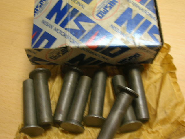

13231-M0821: A high-performance alternative to the stock cam lifters. Each is 24 grams lighter than 13231-H1001.

I'd say these would be hollow maybe?
ddgonzal do you have any weights for these?

I do not know the absolute weight.
Someone can measure stock ones and let us know how much they weigh. Someone said 63 grams?

Thanks. So the lightweight lifters are the go. About 35% less weight!
A set of nine stockers from a forklift shop are as inexpensive as $20 USD. Too bad they don't carry the lightweight ones, which are NLA in USA.

Truly?!
That is a major difference.
I'd assume they are hollow. The 'bell' at the end is much thinner or shallower and there is a little taken off the ends too.

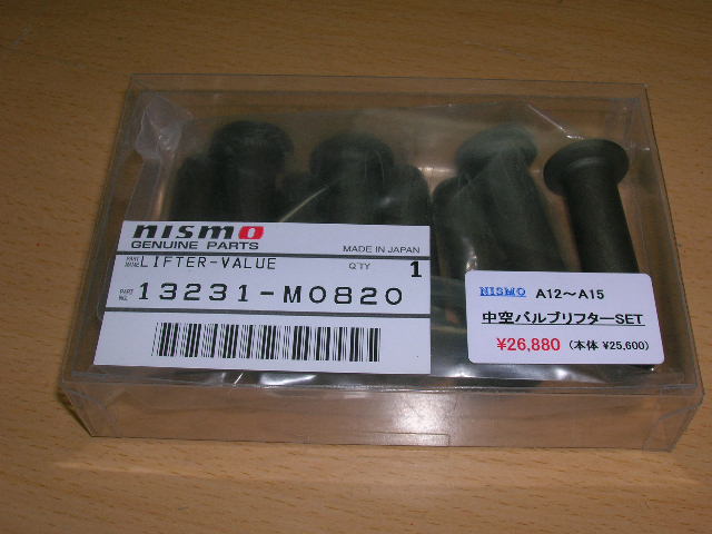

Bprojects: 50.0 g.
NISMO
clyons8

Thanks Sunny coupe!!
Fantastic information.
50g is easy to achieve.
36.7 is something else.

36.7 is something else.... like $382 AUD?

This is our idea.
Lightweight Cam Followers made by NISMO seems to have the old and the new.
As for the old thing, height is shortstop and more lightweight.

Just a note, Nismo no longer make these lifters.
Bprojects has manufactured Lightweight hollow lifters now, so a replacement is available...
