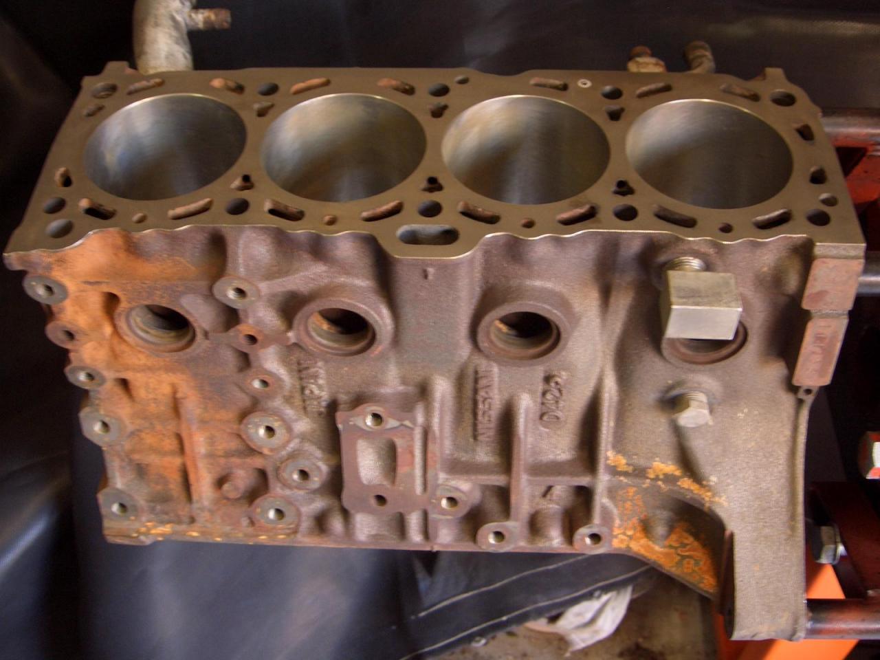

Here is a pic from the side / top of the bare block.
See the rust stained section on the side of the block from where the head gasket had been leaking.
Most of this was hidden by the air-con... Something to check if you are buying one that is running in a car!
