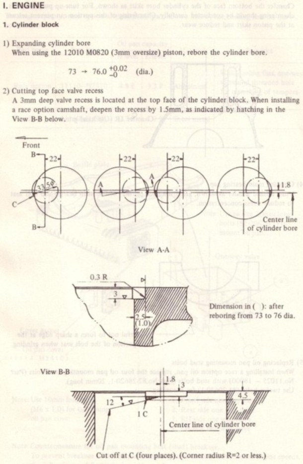

As a result of an enquirey from Kegs, i thought that some might like to see what the factory recomended for the A12. Note that this is for the "expanded bore" [76mm] so it would be relevant for the A14/15 engines

If you want a bigger, clearer copy of this page, drop me an e-mail & ask [nicely]

If one is going after the bigger bores, it might pay to offset them a little to avoid an excessively thin gap between 1 & 2, along with 3 & 4. Measure thrice, bore once.

My pic is of Standard A15 bores, but if you were to offset them, how would you compensate for this, on the crank, rods or pistons

The wrist pins run fore & aft & there should be enough movement available to accomodate. I'm not talking 1/8" here as we must also think of wall thickness. Sometimes just a few thou can help.
If one is boring one oversize up, then keeping the cut on the side closest to the adjoining cylinder to a minimum will mean the smallest amount lost in the deck between them. There isn't a lot of meat here, & blown engines make a lot of combustion pressure, so keeping the sealing surface as large as reasonably possible in a heavily overbored engine [like my 1200] will help gasket life.
Do a lot of thinking, & measuring, before boring too far. I have seen an engine that needed figure 8 "O" rings around the bores because there was not enough meat between them for two full circle rings.
