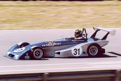

Sports 1300 racers (see pic) who used the A12 engines found that they rocker gear needed more oil for longevity at high rpm. They commonly modified the 'scallop' in the camshaft to increase the volume of oil supplied to the overhead gear, along with common oiling mods to the crank, and used the Lseries oil pump internals as described here.

Thats interesting L18_B110.
Its the reason I started to look into the High volume oil pump in the first place, I found that I had above normal wear on the rocker shaft even after machining rocker spacers to increase oiling of the rocker arms. I guess if you are running high lift cams and big valve springs at big revs then something is going to suffer. Of course roller rockers is the long term fix but my budget wont stretch that far
Thanks for the info.
