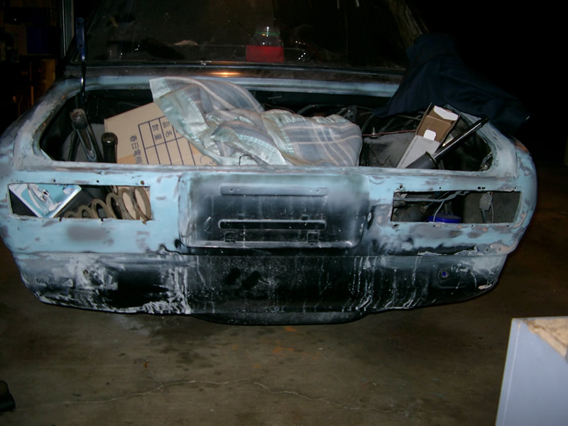

All rust cut and welded from around the tail light area + modification

All rust was cut and new pieces welded in. Found more rust than what i expected. Mainly out towards the far edges of the tail lights down to the bumper and i replaced the whole back piece of the gutter there where the boot seal sits. Youd never know it was there. The previous owner did a pretty good job of covering it up. As dodgey as it was its lasted years without even showing up.
Also the previous owner fitted coupe tail lights which again looked good but was fitted on the dodgy side of things so i welded and moulded the back to the tail lights fit almost as snug as on the coupe.

Fark you said it was apart ,well done that rust has gotta go ,chicken wire too .may as well hit the whole thing like you said ........

Posts: 1356
 Re: rear panel progress
