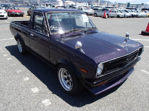

Re: Colour help |
Joined: 2015/10/16 23:55
From Aberdeen, UK
yeh was thinking that, its very similar to midnight purple, just maybe not dark enough.
Posted on: 2016/4/18 19:10

Colour help |
From Aberdeen, UK
Hi guys, just wondered if anyone could tell what colour my b120 is. Its had a respray before I imported it but I have no clue as to the colour or even if its a nissan colour.
nissan b120.jpg (158.37 KB)
Posted on: 2016/4/18 8:31
