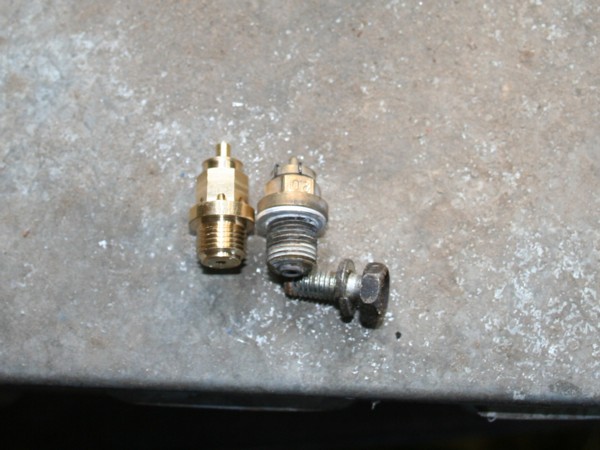

now as you know it is hard to find rebuild kits for these carbys not sure on the flat tops but defiantly for the round tops but a rebuild kit from the early roadster can be found easily and be adapted so here is what i had to do to adapt them
ok here the pics and show what i did as the needle and seats are slightly taller then the originals

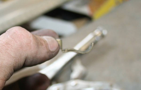

as you can see i had to squash the lil piece of brass thingy
these kits can be found on ebay motors and they come with new larger needles maybe could be used on a hot motor that has gx carbs?
i used these ones
here

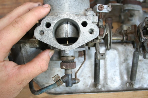

now dont know where to take the vac advance from? heres a pic to show where to take it from this is located under the front most carb

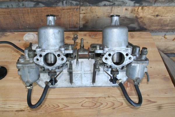

heres the emission type carby's
and the flat top carbys
and the "original GX" type roundtops

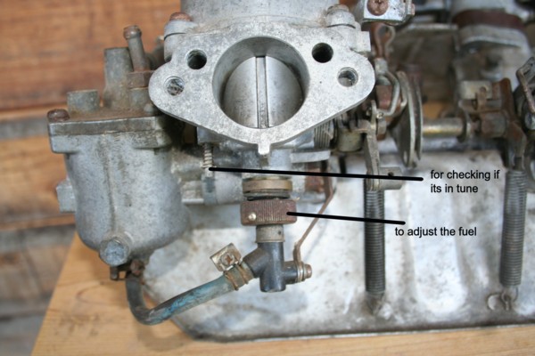

and here is how i have been shown to tune these carbys
this pic shows the the fuel adjusting screw at the base of the su and the pusher which you push and if you push it up and the motor doesnt change revs then it is tuned
heres a pic showing what happens when it is pushed up

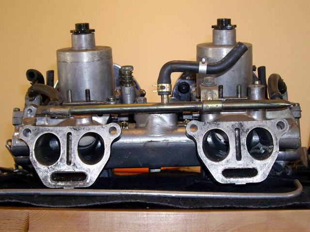

and heres some pics of those horrid twin a14T su's of the emission variety
if you happen to get this type of setup then id advise to source non emission style flat tops or round tops as i am certain that even though they have the diagonal bolt pattern they will bolt up to this style of manifold
pics kindly supplied by ddgonzal (thank you)

Yes, those A14T twin carb Hitachis have a lot of emission controls on them. The pics there are missing the electric chokes and EGR valve, which has been removed and blocked off.
A14T carbys have 4-bolt flange on manifold side, and small 3-bolt flange on air cleaner side.
In edition to EGR and electric choke, they have servo (throttle control) similar to USA emission controlled downdraft Hitachi.
Tons of hoses and check valves and such.
i was always under the impression that if you raise the pin, you want the revs to rise slightly then fall back to idle speed.

Posts: 2079
yes your right thanks for correcting me
