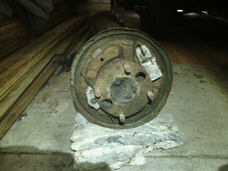

About the 260z finned drums are they easy to get and any mods required D?
Here is what I have:
jpg  IMG_20141215_170404.jpg (145.71 KB)
9665_548ea64288631.jpg 778X584 px
Posted on: 2014/12/15 9:12
Datsun 1200 2Dr sedan.
Re: Wtf h165 drum brake set up
2002/10/28 6:49
Posts: 10987
If you use the Bluebird drums from a H190 S3 then all you do is fit the alloy drums from the 240 or 260z as they use the same parts as the bluey.
This is what Steve Newing did for the H165 rear end on the 1000 coupe that he used to campaign and from what I heard its virtually a bolt on setup. The alloy drums are available from Z wreckers and gumtree.
Last time got quoted 30 a pair from Zworks in Brighton Melbourne but not hard to find.
Drums only provide a small % of overall breaking but when setup properly are awesome for hand brake turns or corrections for cornering, understeer and forced oversteer when power is not always there :)
