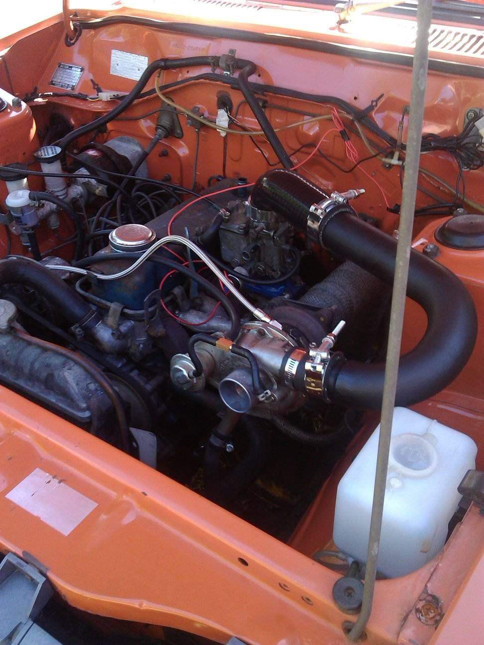

I thought I would post about my 120y wagon, We have owned this little car for 2.5 odd years and found over the last 12 months we haven't used it as much as we should,so the decision was made to sell it....Many months later after being low balled with prices,asking for payment plans,no shows, I thought F...it were keeping it.....So what was i going to do with it.. well Nothing its been a fun car lets just use it the way it is..I mean im in the middle of 351 turbo F100 build....I decided to tidy the shed,there was crap everywhere,then i found some steam pipe and bends,a turbo,fittings as such so a simple J pipe was welded a vw 1600 solex carb and other bits and bobs.... so in 11 days we have gone from std motor Na to running 98 and 15 pounds to E85 and 11 pounds on what was a stock motor,fuel sytem,and points and still is,

Here it is....

I must admit,with the turbo how much different it is to drive ,Im really enjoying...but I now feel i have reached the limit for a stock system E85 has made a huge difference but also has strained the simple set up and has highlighted many weakness,also another thing was E85 is so bloody forgiving even when i haven't heard any detontion but reading the plugs says otherwise Im doing my last Modifiation on the carb and if this doesnt make a difference then i will drop the boost...Im going to keep pushing the envelope with this little car just wish I did this years ago! Cheers anthony

cheers mate yes the dizzy has been locked, The problem isn't timing it's happy locked at 25 deg regardless of the boost pressure, the issue is Fuel distribution.. Watching the O2 gauge it showing 10.9-11.3 underboost But the reading is the average of all 4 pots 1&4 are running richer and 2&3 are leaner when reading the plugs it's showing slight detonation/lean with 2&3 so i have enlargerd the main jet and progression jet but this is about the limit and this time i have solderd the emulsion tube completely to avoid leaning off..... I have gone as far as it can with the current set up.... The more boost i run,im having to close the gap because the secondary field doesnt have enough balls to fire a good spark. The stock fuel pump is at its limit of flow thats needed with E85 and supporting the boost im running(not 98),Im up to around 53% increase in jet size over the 98 set up! I know what needs doing so theres no point hurting the motor chasing extra power,i will drop the boost down be happy with what i have achived for the minute.. cheers anthony
