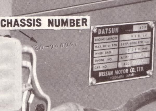

the wee number on the guard
well can not see it
near battery placment mount
brake master cyclinder
where
Just send me steve wonder he could find it I bet
plate state's
A 10 673805
B 10 247294
which I have taken as well as the pit's ( pit inspector's)
as the right sign
anyone have photo of where the number has been smashed into the inner guard
stilll scratchin my head

It is stamped just infront of where the plate is on the drivers side. I dont know if my ute is B20 on the plate coz some tool painted over it and when i used thinners to take the paint off it took some of the original markings off too!
Mine is apparently a '69 and is stamped B10 in the chassis.

From what I can make of it, the serial No. B10 247294 is for a 1969 model Datsun 1000 sedan [From C/# 200001, from Oct '68]
The 1970 model C/# [Car number] started at B10 350001 [from July 1969]
The A10 number is the engine number of the original powerplant that was used in the car that originally used that tag.
This shot is from a [L] B20 owners manual & it shows this number to be just near the fuse box.

FOUND IT
state's
b 10 chasis (vin)
247294
two pak paint worked better than bog in some place's
