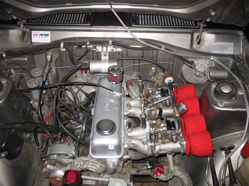

I got my ute back from the tuners today, i couldnt be more pleased
Just the INSTANT response of the engine is priceless, its most definaltey a huge increase over the A15 i had in the sunny.
This cam is well suited for the twin 40's i have hanging off the side too..midrange power is awsome
Theres a nasty 'tick' tho coming from the back of the engine ive noticed, the tuners didn say anything but just on the way home i noticed it. Its not tappets but it sounds like its coming from the heater vent or PCV system... any ideas??

Pics up, can somebody post it in here:
http://datsun1200.com/modules/myalbum/photo.php?lid=9567
iopnions most welcome
Check out your extractors...my pick is that you may have a leak on the rear flange plate where it bolts on to the head. If it is that the noise will be noticably worse under acceleration but hard to hear on idle.
Easy way to check is to use a length of small pipe (Like fuel line) hold 1 end up to your ear and hold the other end down around the flange while the engine is idling...you will hear even a pin hole easily by following right around the flange plate. Check them all.
