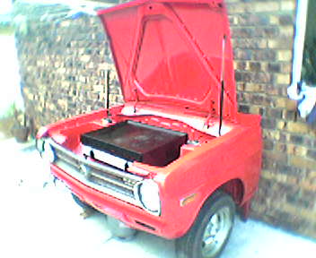

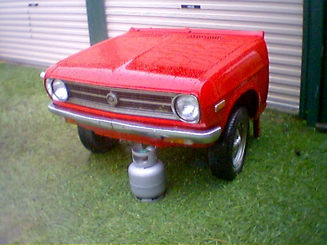

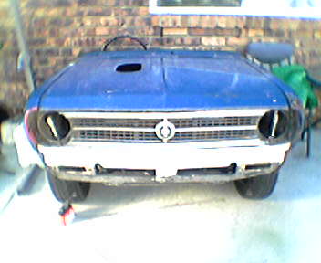

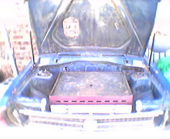

You dont realy need any plans, but i will tell you how i did mine.
1st you get you self a car or just front end. if it still has wheels thats great.
2nd remove front window and front doors.
3rd remove very thing from the front doors forward, except the crossmember and struts and wheels.
4th take youe trusty angle grinder and cut through the sills acroos the floor just in front of the seats.
5th cut through the bottom of the front window pillar.
6th make a crossbar with legs ot go under the floor to make it level.
7th pick a suitable bbq unit to mount in the engine bay.
8th using box steel make a legs for the bbq to bolt to and weld them to the car. or you could bolt them if you don't have a welder.
9th paint the shell and panels.
10th put it all together and there you have a car barby.[img]http://datsun1200.com/modules/myalbum/photo.php?lid=7903&full=1[/img][img]http://datsun1200.com/modules/myalbum/photo.php?lid=7904&full=1[/img][img]http://datsun1200.com/modules/myalbum/photo.php?lid=7901&full=1[/img][img]http://datsun1200.com/modules/myalbum/photo.php?lid=7932&full=1[/img][img]http://datsun1200.com/modules/myalbum/photo.php?lid=7900&full=1[/img]
