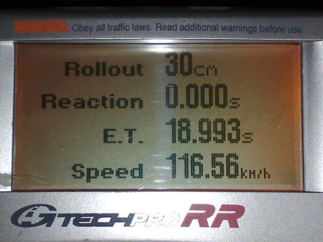

ran full dyno... but still no 400m readings...

ET - Estimate Time for 400m (i didn't complete 400m ma)

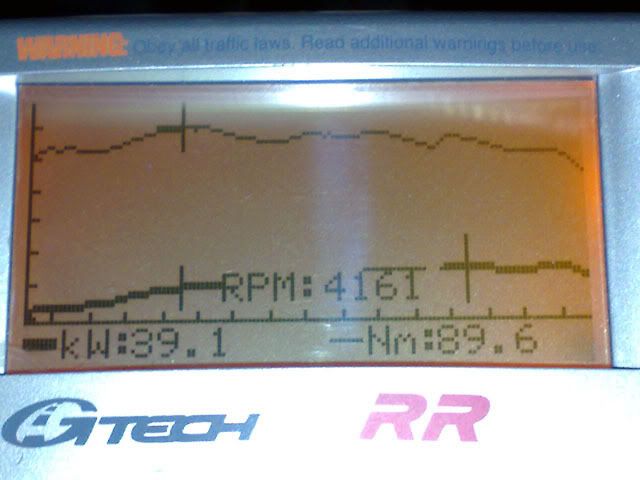

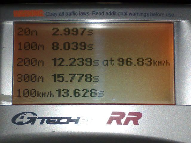

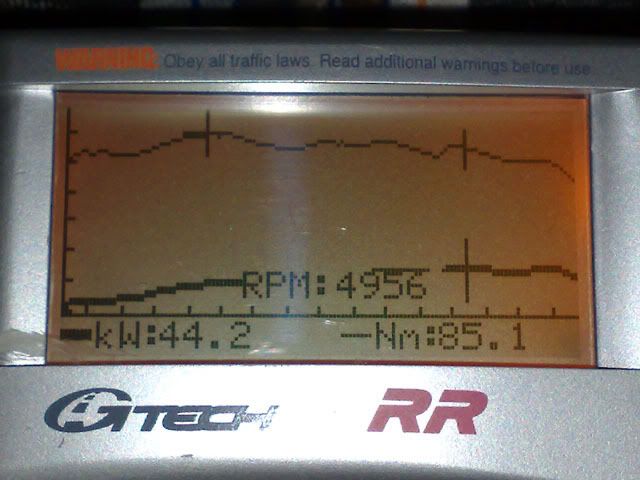

Summary of readout and testing...
0-100kmh @ 13.626s!
max torque 89.6Nm@4161rpm... 8.96kgm
max HP 44.2kW@4856rpm; 59.27NHP@4856RPM

your elapsed time E.T is the 400m time. 18.993
EDIT didn't see your comment about not completeing 400m. How far did you actually drive? Maybe it estimates from ground you did cover.

i set the shift light to 5200rpm, what i did was about 350m as the road was actually just about 400m, but i do need to brake before the road ends right? It's just an estimate time for 0-400, as i finish my test in less than 18s (from the top speed time). so after 350m i was just braking. i think i need longer road to get the 1/4mi ET
The test stops just after the Gtech experience negative G (deceleration) for few seconds.
the weight set was 1100kg... i weighted the car was 970kg dry (without fuel). compensate for my weight of 85kg plus all the junks in my car and a full tank of fuel. This is a daily driven car for me to commute to work and back...
