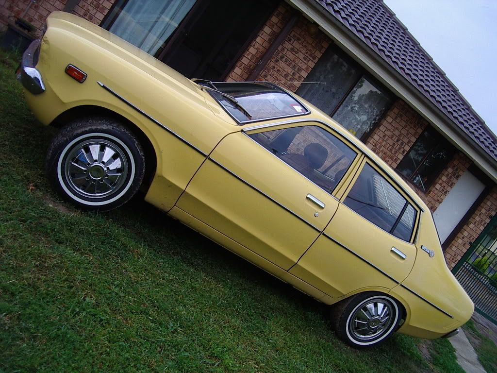

rearrange the leaf pack, only takes an hour, costs nothing (need some tools) and you wont be dragging the lower spring mounts on the ground. May stuff your shocks though over time.
Not a 1200 ute but my 120y went from:
To:

its not, he rearranged the leaves in the pack, eg. flip one and reassemble the pack..
if you do this i'd use a shorter shock, like holden/izuzu gemini ones
