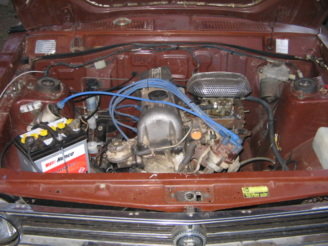

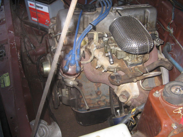

Keeping Mr Hanky. Cross member gets the knotch job and took a bit out of the bottom lip on front side Now to lower the engine a lot more. Heaps of front end bits all painted up with new bits ready to go in, Pics To Come tomorrow.

Update. Tailshaft is off getting shortened 48mm. Got some engine mounts off getting modded to go another 5mm lower. Engine has all the basics connected and it turns over. Now to re route some wires e.g dizzy, temp etc. Plum up radiator and heater hoses and put in pedal box slave etc. Getting excited and i nearly gave up. Thanks guys for Answering me PM's most recently Whitesedan it kept me inspired.

She's gonna be fun... is that a 32/36 I spy?
