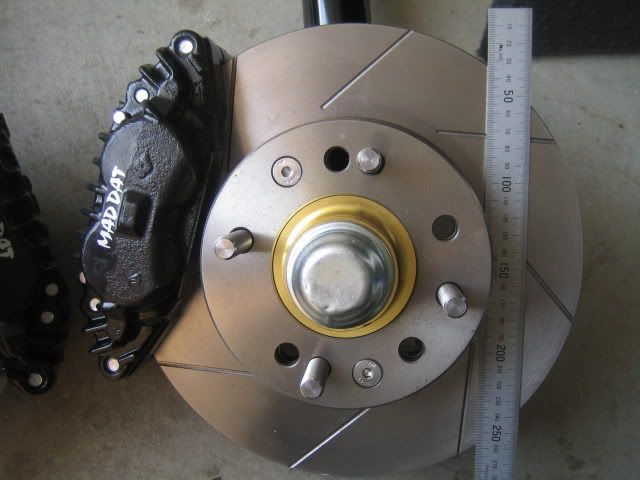

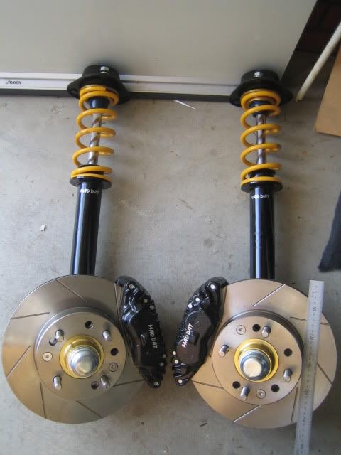

Well, I did spend some cash and get some parts sent to me...
They are the maddat items- 280mm S4 rx7 items. Have gone the alloy hubs, with lowered struts. Will hopefully be enough to shed some top-end speed :)
Will update as I can, and some more things get done...

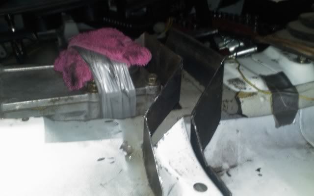

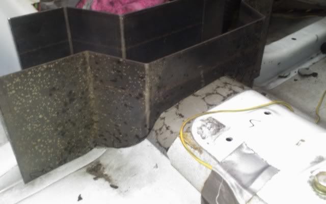

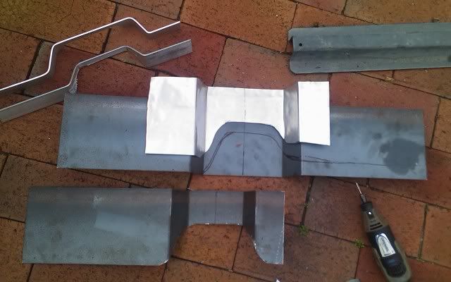

I did get some work done last weekend on the seat reinforcing..
I had some metal bent to my alloy templates (top left), and then used some alloy flashing to get a basic guideline for cutting the steel.
A pic of the back, after quite some time with a grinder and a dremel...
Bit of a crappy pic, but this is after taking some of the top off. Will weld these two pieces in & then put some 'capping' over the top to link it all back together. Not sure if I'm doing it right, but the strength should be there when it's all done.
