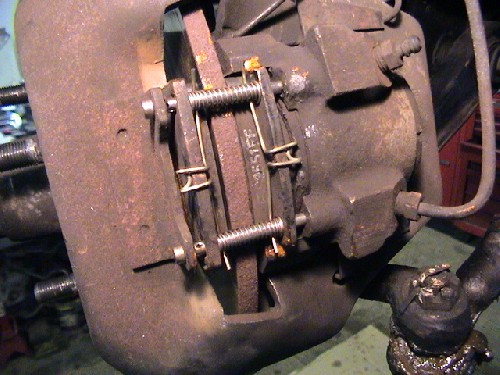

I took a look at my front brakes this afternoon. I raised the car up, made a chalk mark on the tires, and gave the wheels a "spin test" [by hand] and counted three revolutions each side. So I decided to take them apart and clean them. I lubed the slides and found an NOS hardware kit in my basement. I took advantage of the kit's extra parts to add a second spring between the pads to help them release more completely. Normally there is only a single spring on only one of the pins. The spin test yeilded 6 2/3rds revolutions afterwards. Must have helped.

Every bit helps! Cant believe it made such a huge differnce. Nice going
