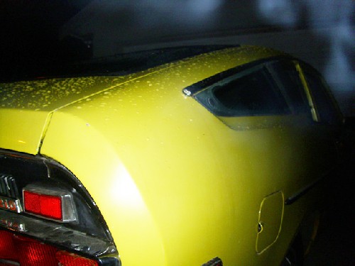

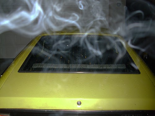

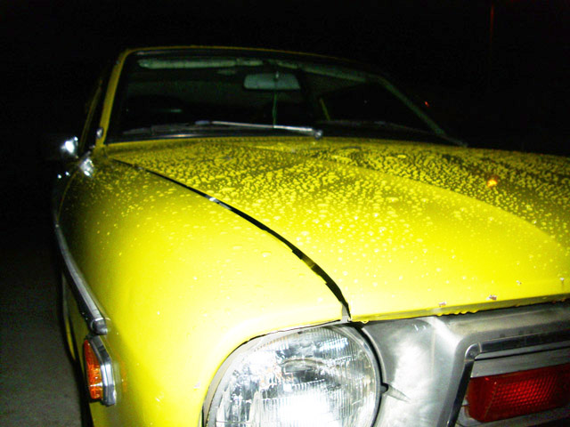

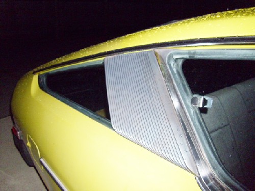

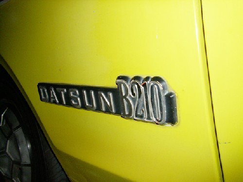

ah that bastard year thingy my manual says 73-78 cant believe everything ya read these days...heres some pics i just took tryin out my new camera.... it rained earlier so shes a little wet.(not bad for orginal paint)
