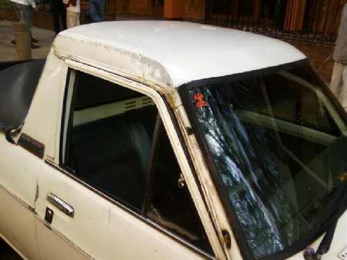

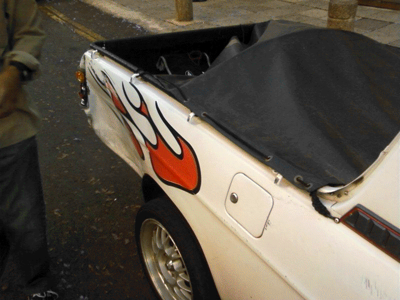

Bad news, is that my ute was involved in a accident, It flipped on its side. Had a drunken driver(a woman) knock into my back end whilst on a highway.I had my wife in the vehicle as well, and luckily we got out without even a scratch.
The Ute, once put back into its fours, started on the turn, and not even a whiff/smell/sight of smoke, despite it landing on its side, and dragged for about 60metres at least. I actually drove her home, However the side shaft in the diff seems bent.
This womans insurance is paying me out for damages etc, Her car is a write-of (toyota Yaris)
Since my Ute being so Dependable, reliable,Tough and safe Ive decided to give her a new lease of life cos of her saving me.
I will be putting in cowley Branches/Extractors firstly. I need to put in another Carbi.
Do i go SU twin carbs or a webber. I am not going to do any work on the engine or head btw.
See pics just after accident.Only pics I couldve taken, as my Battery life on my phone was Low
