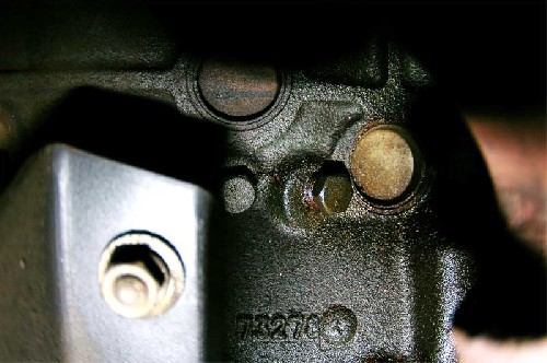

Thanks DD. I have a late model a12 and it appears I have both bolts! One directly underneath and one behind.

Which block casting number is that?
H79 or H50 ???

Not sure where to check the casting number, but it says M22 where it says M72 in your picture of the late model engine.

Yes, that is the block casting number.

M22: A12 block casting from 1974-1978 B210
