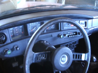

Leather dash installed
jpg  Datsun1 035.jpg (68.68 KB)
11027_4ba4007215116.jpg 314X235 px
Posted on: 2010/3/19 22:53
