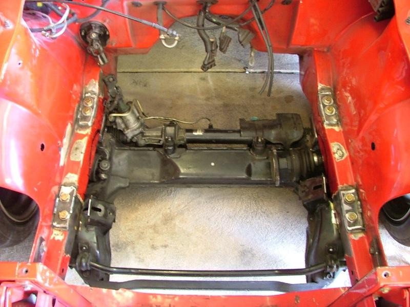

Then the engine crossmember, thinking of usuing the r32 k frame, that way I could run the r32 powersteering rack and there would be room for the front diff.
Here is a pic of a celica with the r32 k frame fitted in

On a slightly more serious not. The r32 K frame will be about 150-200mm to wide from memory. I looked at fitting a s13 k frame to my car at the start of the project.
Not saying it won;t work just that it will require quite a lot of fab

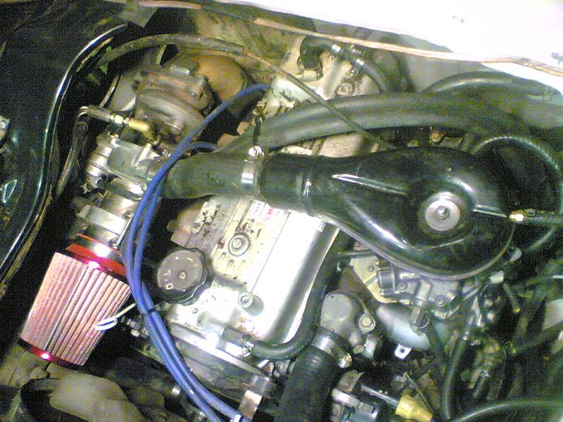

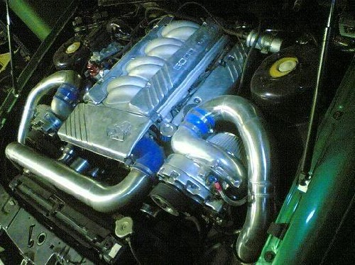

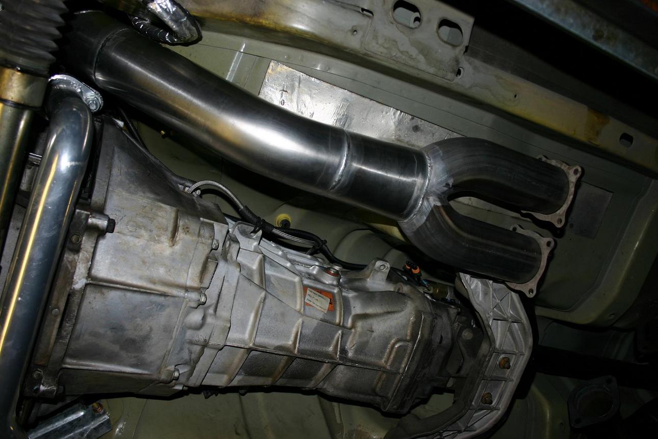

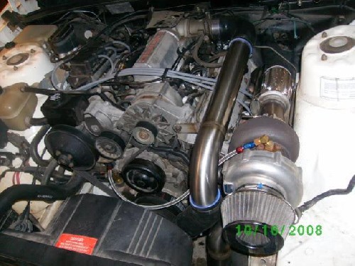

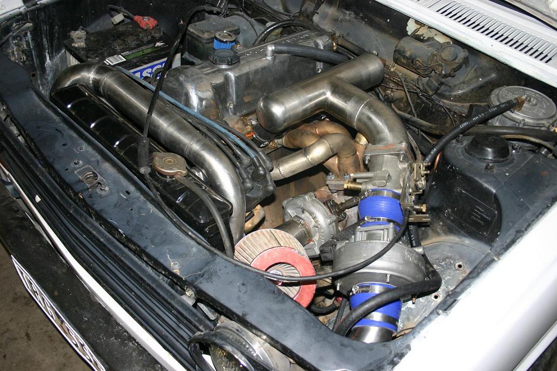

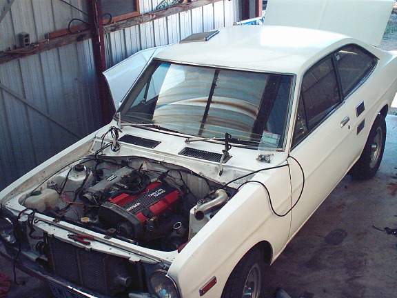

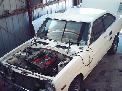

I was one of the first on the 1200 site to complete a ca18det conversion, it was in a coupe and that was back in 2002 user name back then was "go_the_datto" but I cant log back in to that account for sme reason, a few other projects I have compleated are a
-turbo L20b 1600 intercooled with a blow through lpg set up
-289 windsor and C10 auto into 1200 sedan
-draw through lpg turbo L300 mitsubshi van
-rb20det bluebird
-twin vortech supercharged vn v8
-turbo vn v6 manual
all these builds I did the fabrication work myself, I then bought a few off the shelf kits, one was a ls1 turbo set up, I fitted it all up and did the fabrication on the 3.5" dump pipe to twin 3" df exhaust,
So even though this would be a big project from an engineering point of view Im up for a callenge
jpg  546.jpg (39.99 KB)

jpg  Picture 001.jpg (173.70 KB)
