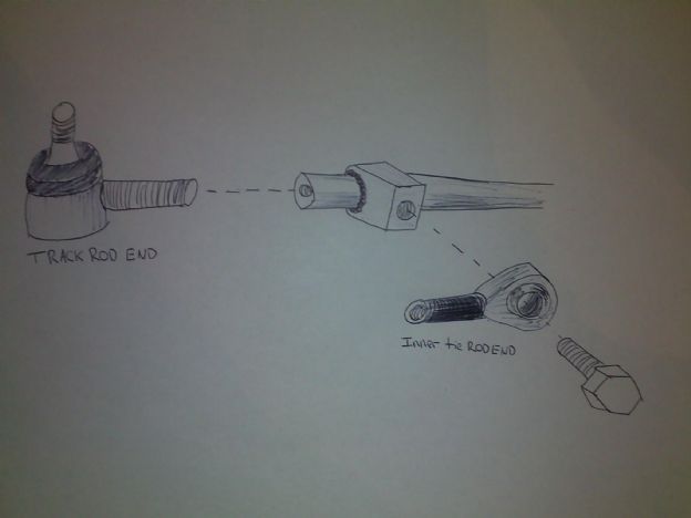

I think I know how to build a custom rod.
Just a thick bar with a hole in both ends to wind a track rod end into and a sleve welded on both ends to attach a rose joint.
I drew a quick diagram of what I am thinking.

Looks like Datzon has solved this one for us.
His thread with reconditioned track rod.
Thank you Datzon.
I sent Mad Dat an email asking if they can reco my track rod, they replyed with...
Hi Ashley
The price to recondition it depends on what condition it’s in. Usually it’s $70. If you post it to us we can confirm that on arrival. Don’t be in a hurry to post it, we are on hollies for two weeks. It will arrive safely, but we can’t work on it for a few days.
Post to: Lot 3 Cemetery Road, Scott Creek SA 5153 and include your details.
Cheers
