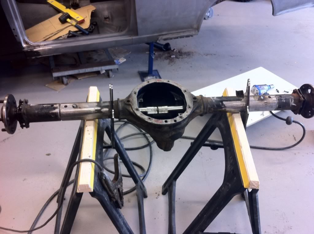

Hey guys,
been a while since i've done any work on the ute works been flat out (thankgod for syd's awsome weather)!,
bit of an update.

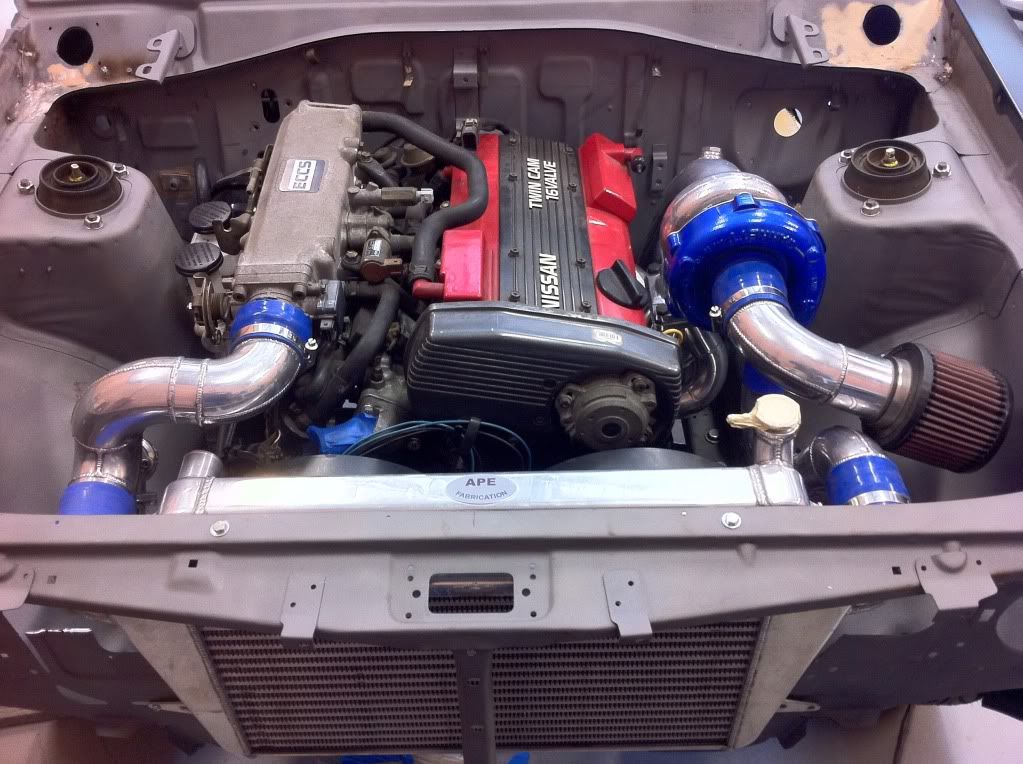

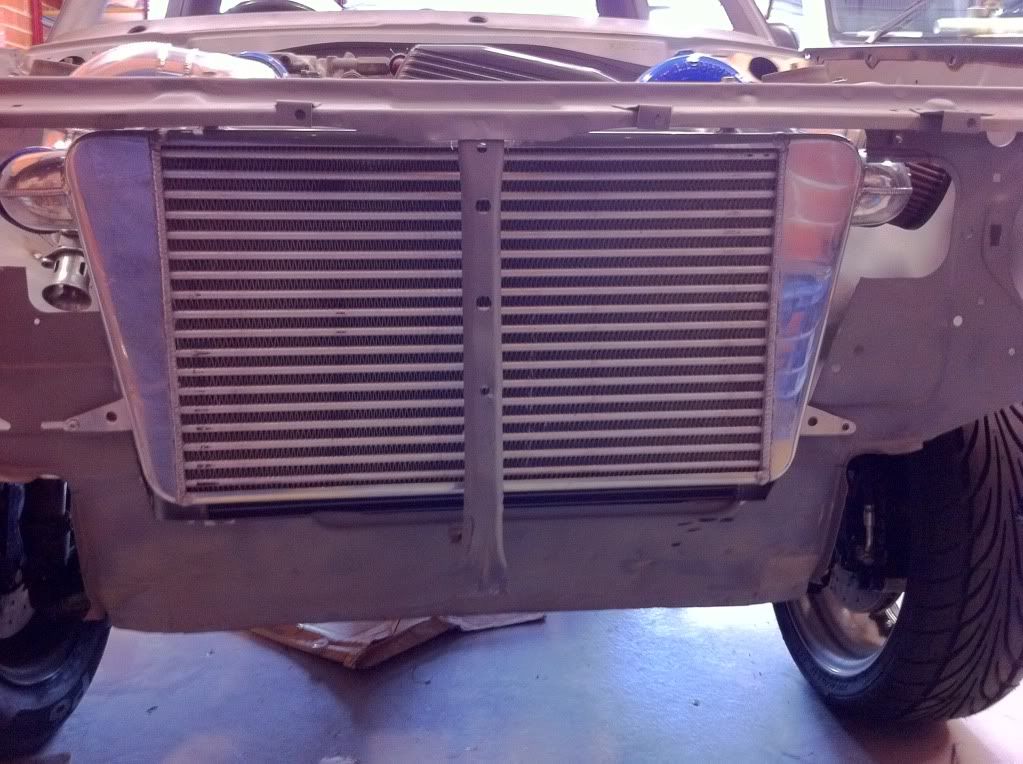

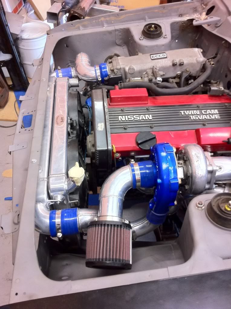

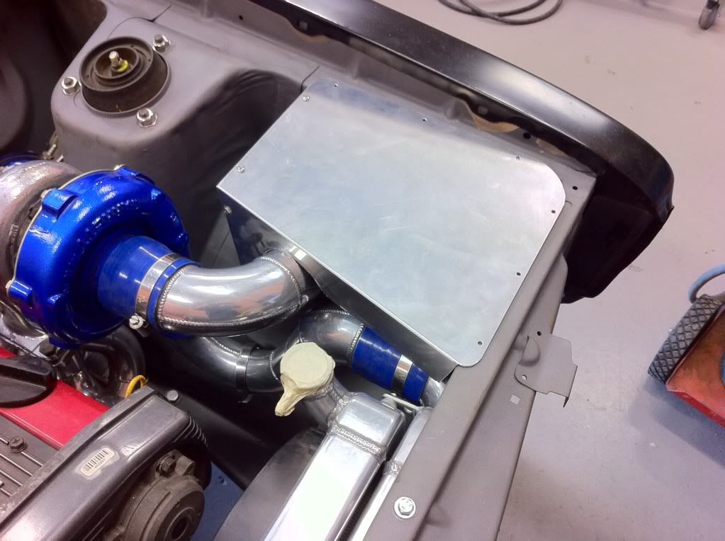

mounted intercooler,radiator and plumbing

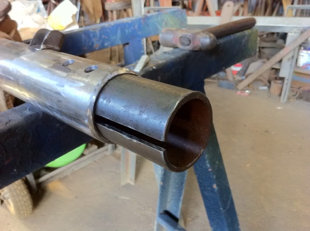

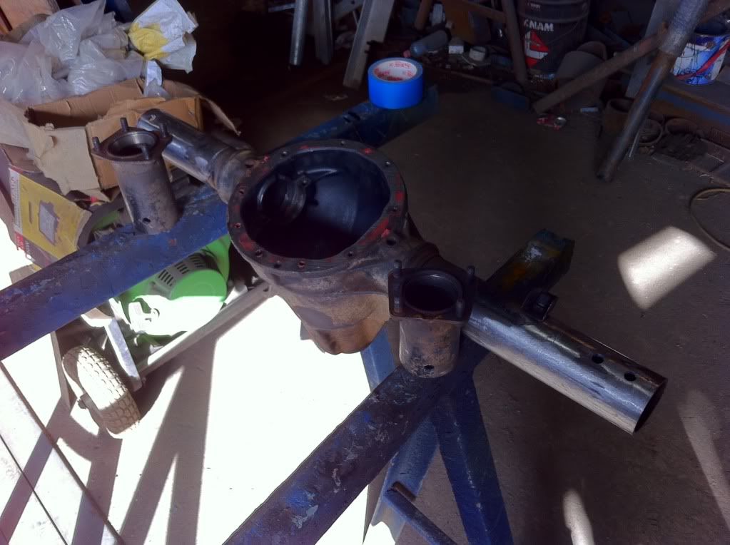

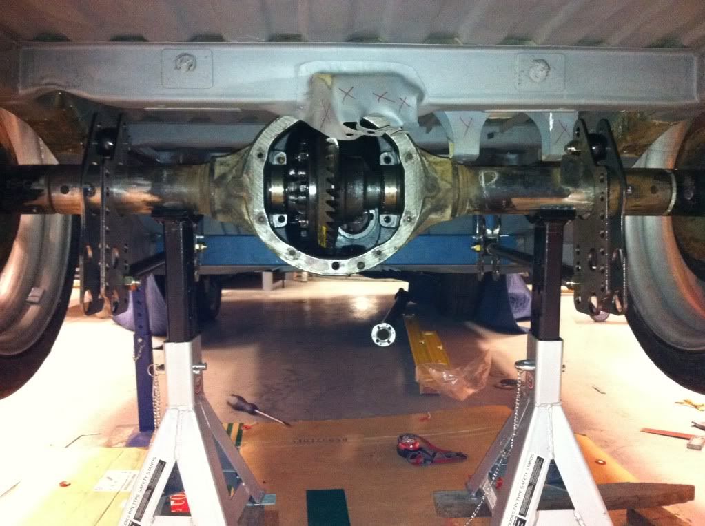

almost done shortening the new diff, went 15mm shorter each side to allow more clearance, hopefully get my axles back tomorrow.

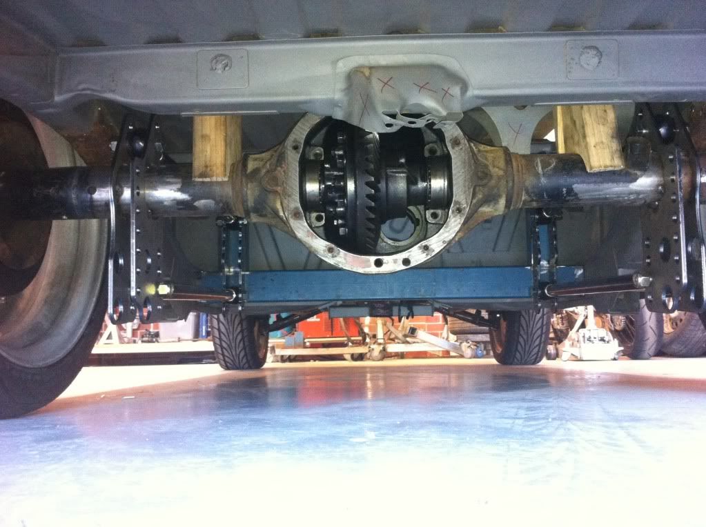

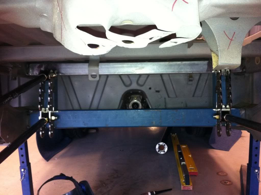

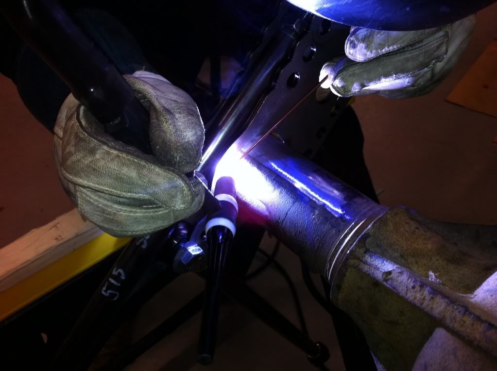

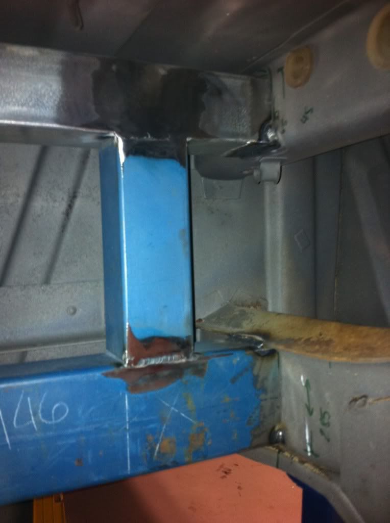

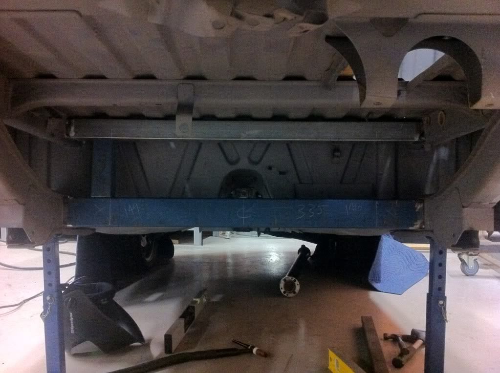

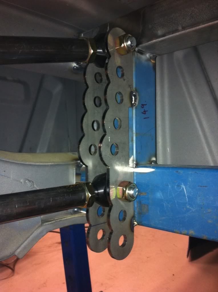

started the 4-link install tonight.bottom rail needs to be split to install a tailshaft loop.

haha thanks shoota, got the bars n bracketry from mcdonald bros in vic

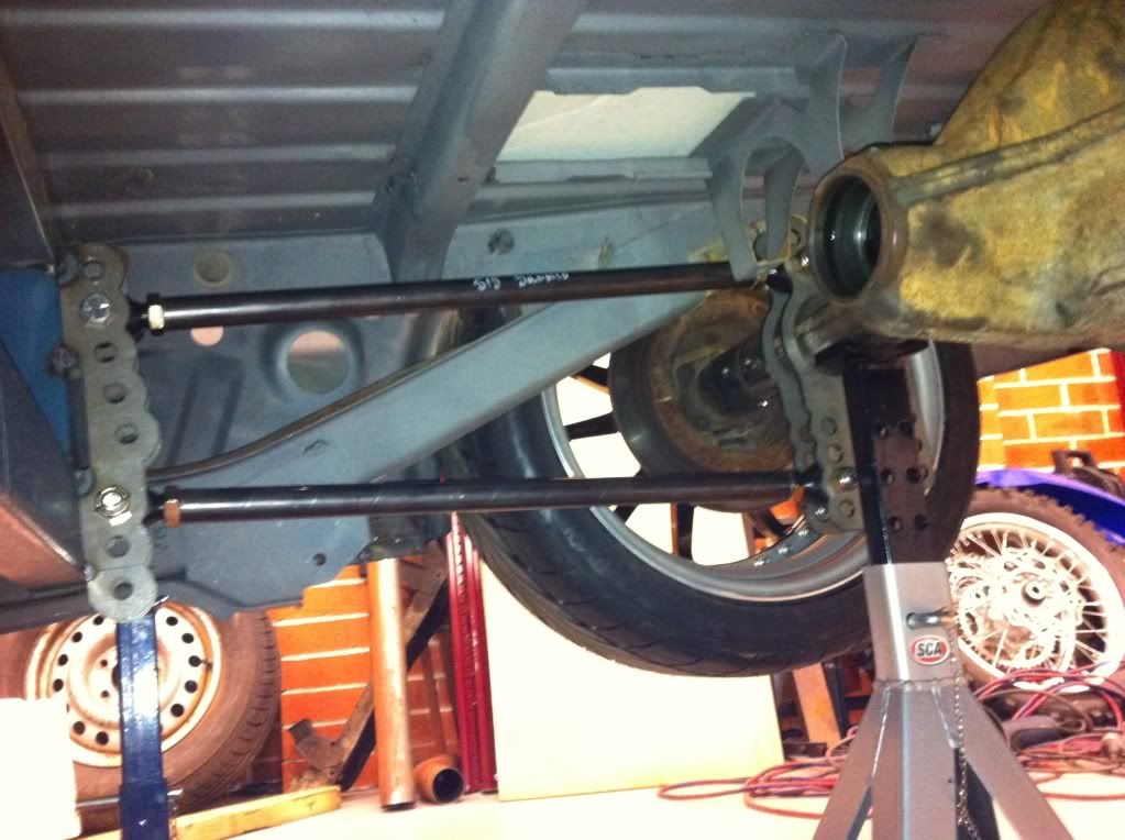

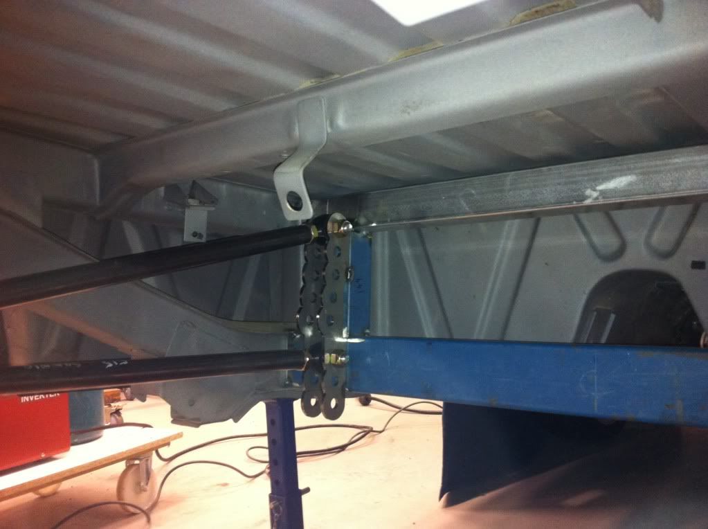

got the 4-link all tacked up yesterday with the help my bro in-law, ALOT of measure and head scratching! but came up sweet in the end. just need some coil overs now.

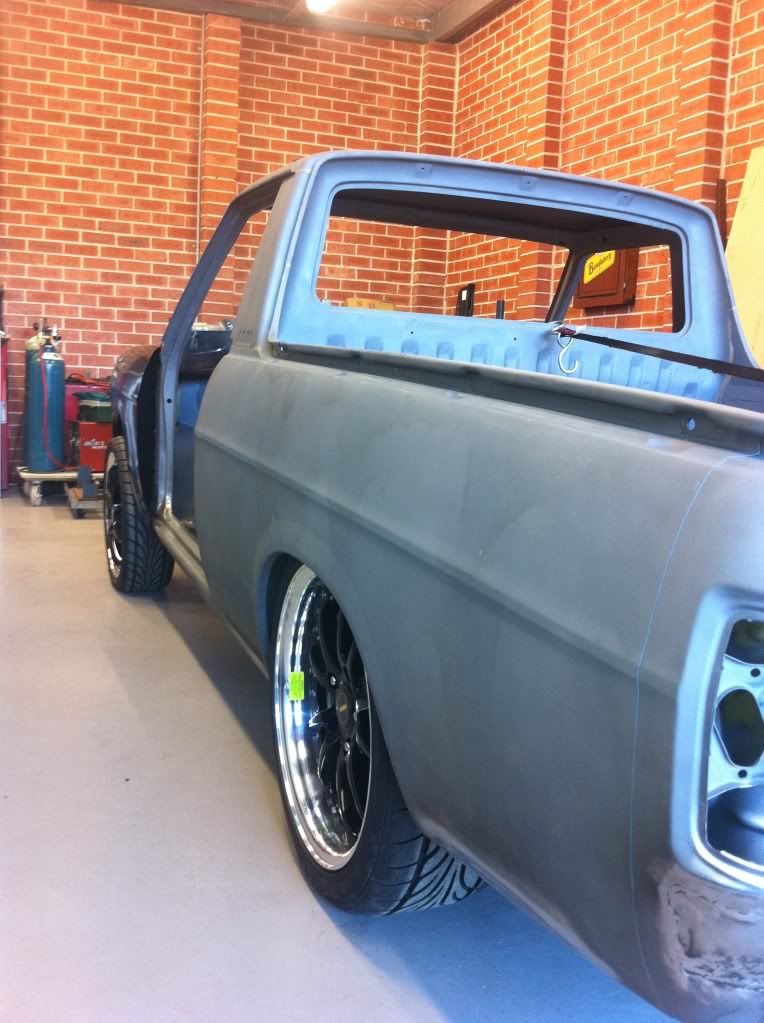

ride hieght

Love the ride height! It's getting there bit by bit.

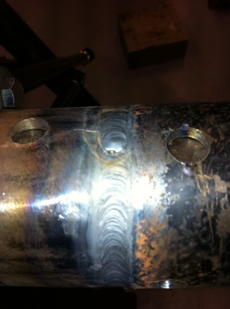

Awesome fabrication skills!
Nice welding.

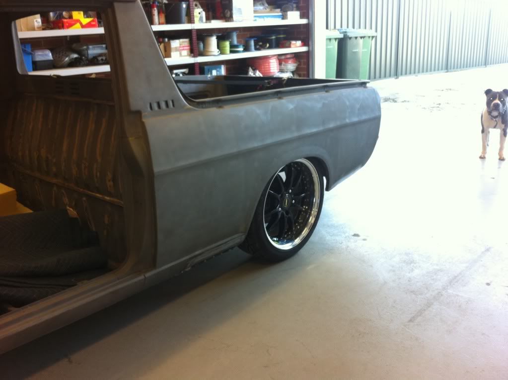

thanks guys,
hey lachie ride hieght's comfortable with good clearances. slowly but surely!lol
wards! thanks mate, went bald scrathching my head! hate to do it in a sedan! but go for it i say!lol
thanks ed all those years of bustin ass working for the old man payed off so far!
can't take all the credit though my bro in-law joe was on the TIG! great welding skills.
Posted on: 2011/7/27 6:54

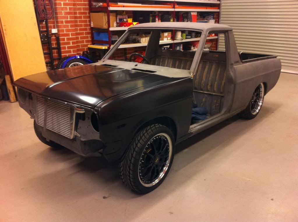

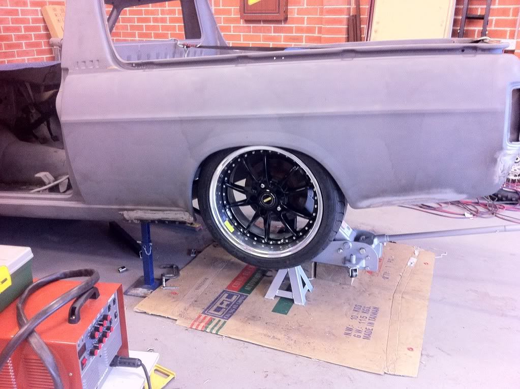

got it rolling for the first time! looks like it's ready to go to the moon, front struts are next on the list.
ill put a post up in the main forum regarding modifying the 180b struts been reading heaps on here but i think im more confused. any help would be greatly appriciated.

HI RSR100 love the build i know that u have 17s on the beast but what width rim u running and what size tyre u got under there,i am tubbing mine to the rails,movingthe leaf springs also cutting the lip of the gaurds and pumping them.I like the ride height and also how u have tucked the tyres under the gaurds which is the only thing i have asked of dave the guy that is doing the diff conversion for me.I am putting convo pros on mine to start of with then will probably go 17frs as tempe tyres have the moulds.
