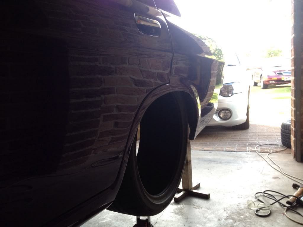

Posts: 765
I deleted the triangle front window had custom glass made and made new window brackets in the door.havnt seen a sedan like this and looks 100x better :)

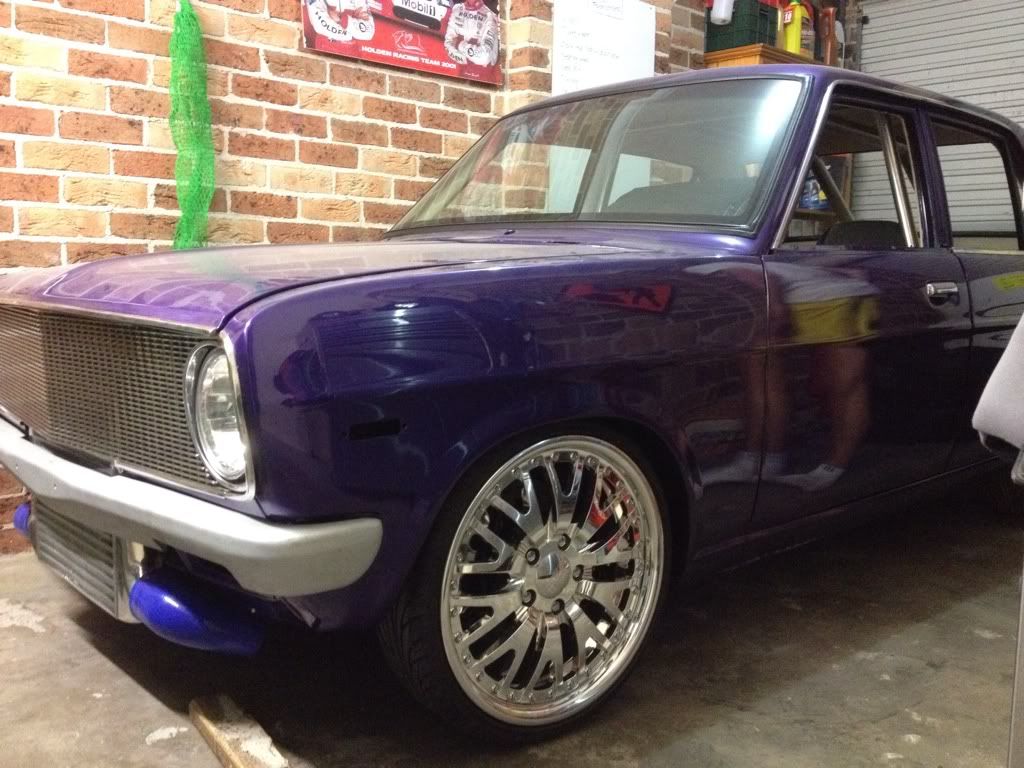

Posts: 765
Another angle.looks way cleaner.real happy with it

Re: Finally start my 1200 sedan build thread
Nice and subtle. Add power windows now
Posted on: 2012/10/9 12:22
2003/11/27 13:29
Posts: 907
I had seen a 1200 ute with the front quarter window removed some time ago and wanted to go that way myself. Spent a lot of time looking at old toyotas to see if I could find a window that would fit without modification..came close, but no luck.
What sort of money did they charge for custom window glass? Is it flat glass or does it need a tiny curve in it? Did you have to make up a new channel for the front? Looks great!
Posted on: 2012/10/9 14:21
2010/10/25 10:06
From Narellan,Sydney
Posts: 765
Yep there is 1 ute that has it but it's no street car.glass is curved and no you won't find another window to fit.its a big job so don't do it unless you know people and know what your doing.i had custom made rubbers and channels made to suit.and changed the window reg

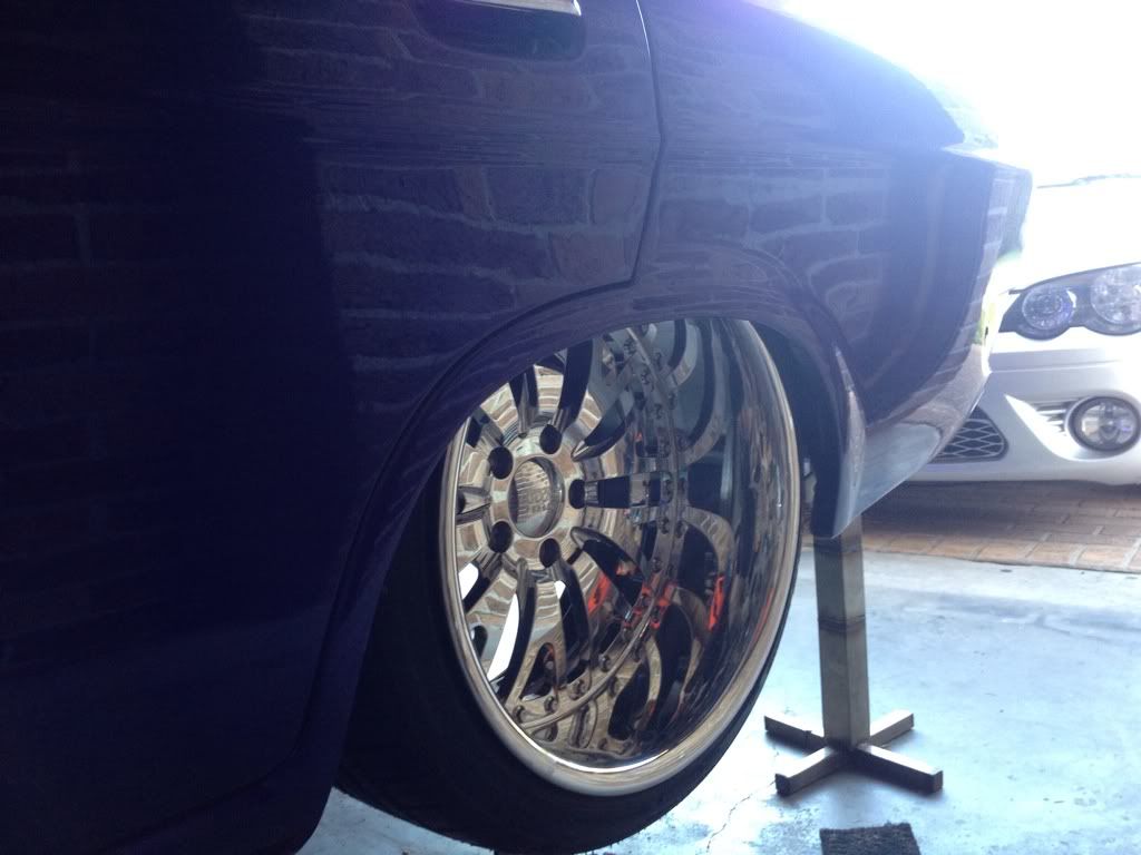

Posts: 765
Finally now sits nice on my billet 17x10" showwheels at the rear and 17x6.5" up front
2008/6/8 13:36
Posts: 3274
love it!
