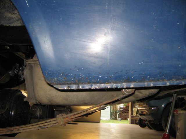

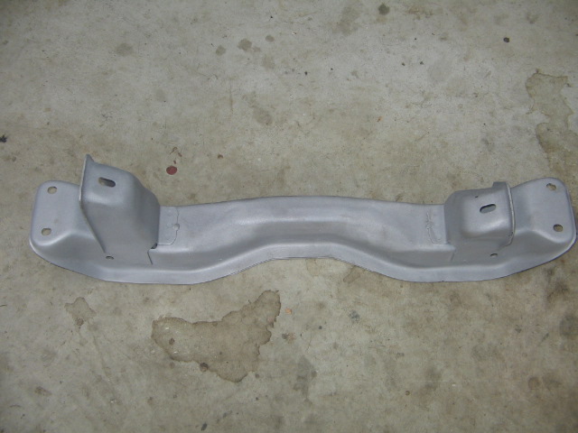

O.k After reevaluating the ute project and deciding to scrap it and go on with me wagon. Got the late ute crossmember sand blasted today then primed it and hit it with some satin black. Then put it back in and fitted me little 120y A12 and sunny smooth case. Should be a little beast. Need to make gearbox crossmember pretty sure i can get the box in and out with that tunnel.

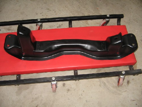

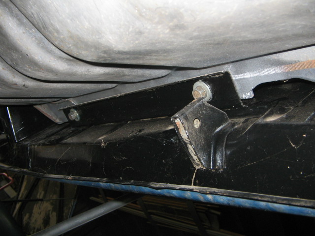

Well its been a while again but im back to it. Have the CA X member, mounts and coil over kit on the way. Removed the mounts off the mystery (possibly datsun 520 ute H190 ) diff and sat it all in all lined up bolted in rechecked it and tacked the mounts back on. Looks tough i reckon should be enough for CA18DE. Now going to re fit the centre and axles then start fitting the R31 tank so i can put wheels on and drop it down to check clearance around diff and fuel tank.

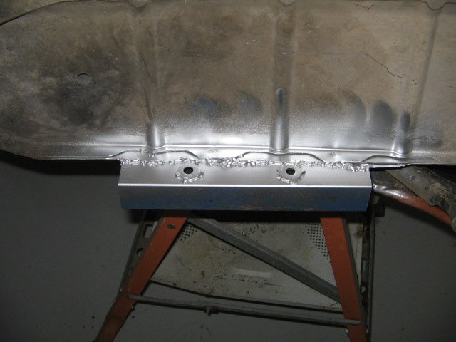

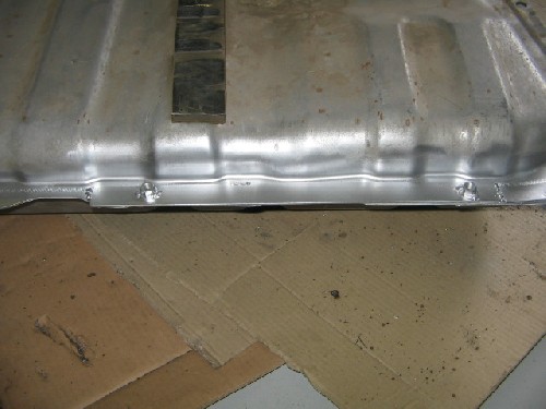

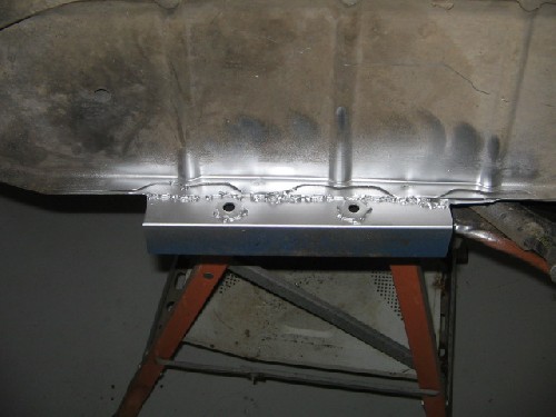

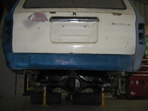

Well welded some flat to rear of tank and some nuts and welded a bit of RHS to the front with some decent flat washers. Need to brace the front one up a bit more but its mounted and ready to move on to marking and relocating the filler hole. Heaps of clearance on the diff as i jacked it up at one point from under the diff. Got me CA X member and coil over kit the other day(Thanks Nik, Supafatto). So more stuff to keep me kicking on. Till next time Adiós
