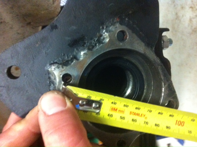

I am new to this and trying to put new wheel nuts in have ripped the retainer off the diff housing.
would like to know what kind of diff it is and where I could get another retainer to hold the axel in.
center point of holes on the diagonal is 900mm

That one has been modified. We could identify it with more photos of the centre portion of the diff.

Looks like the end flange of a H165 housing to me

H165 and H190 axle housing ends look the same, don't they?

And H150 too.
Only the H145 was smaller.
