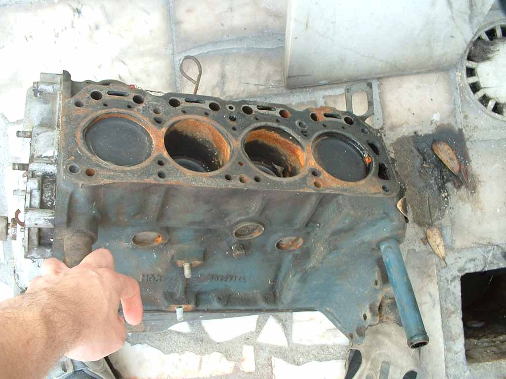

Yes, I see what you mean. Here is an original H10 (Datsun 1200) block to compare. I see what look like two drain plugs in your photo, but only one in the H10 block.
What is the casting number on your block?

There were also older M08 blocks for A12 engine, but they did not have two plug bosses, at least not the ones I've seen. They are identical to Datsun 1200 block as far as I can tell except for the bolt on parts like oil pan, water input tube, etc.
1971 M08 block
