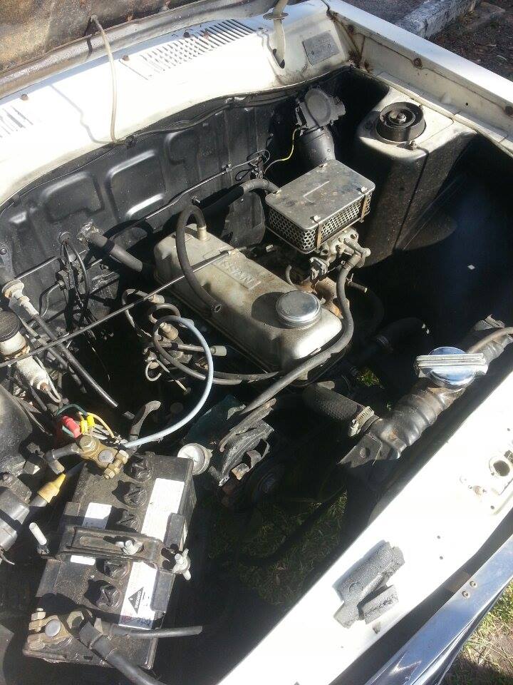

Here is an M22(?) block A12 engine. Notice it has the new-style motor mounts (it is a mid-dizzy engine).
If this block is fitted to a Datsun 1200, the motor mounts need to be modified or a short/tall crossmember fitted.

and this is the engine bay
