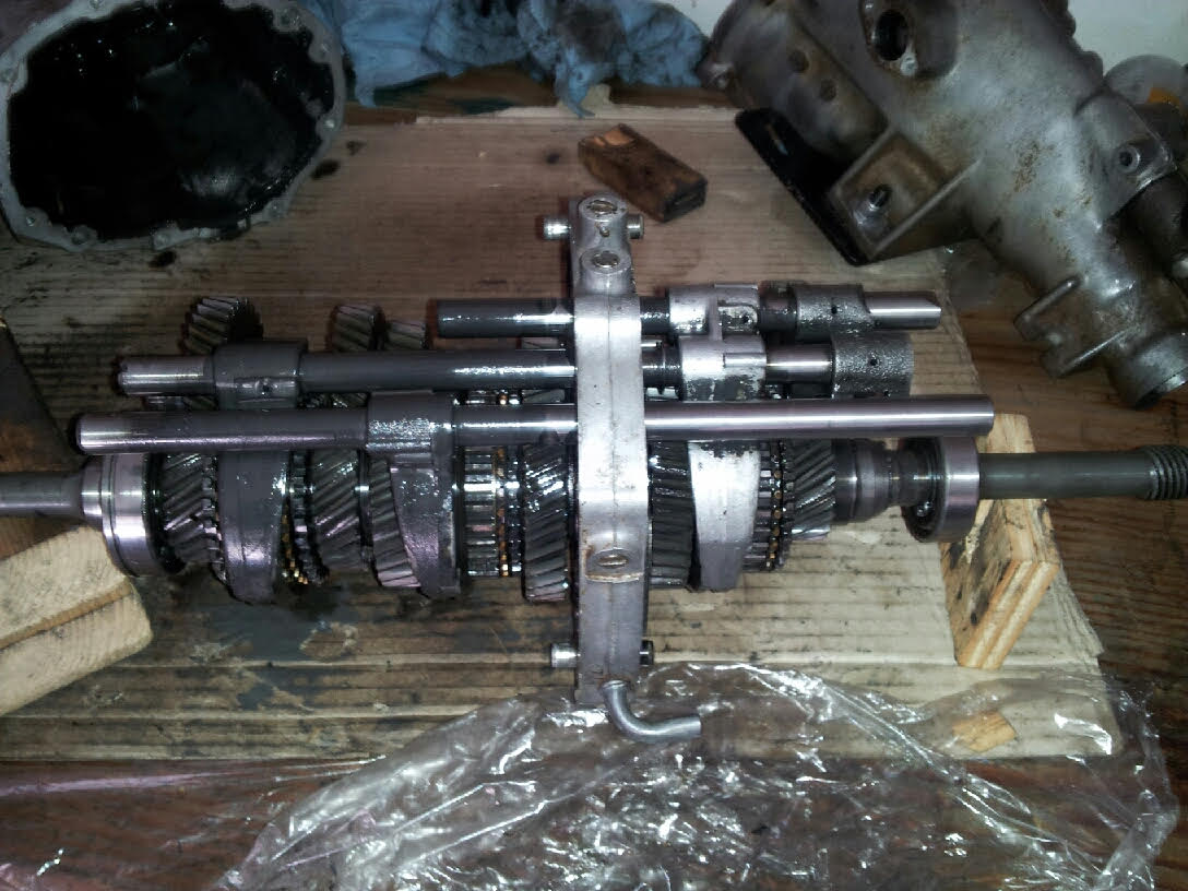

Thanks Andy. Set a block of wood on the end of the main input shaft and after several blows with the rubber hammer it backed out of the transmission case. There was no way this was going to come out by holding the gear assembly and hitting the backside of housing as the service manual calls for. That main bearing is really set in there good. The shop that sold me the kit also repairs these transmissions and he does the same thing. All the gears look in great shape. Kudos to Nissan once again. The main bearing is the only one that seems to require replacement but will change all of them out since I have the entire kit. I attached a close up of the bearings and seal for your reference. The seal appears to be made in Taiwan and the bearings in Japan.

DD...got this kit from a supplier here in the states that rebuilds them himself. Paid $199 with the synchros. Looks to be quality bearings (made in Japan). You familiar with the brand? I think he sent me an extra main input shaft bearing. There are two of those and two smaller ones, total of 4 and two needle bearings. I can only see two roller bearings with the gear assembly all together. Once I get this opened up, I will post back with questions/comments.
