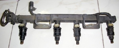

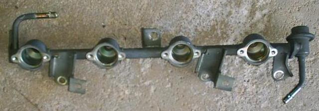

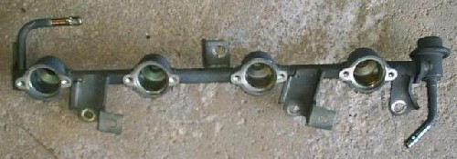

No performance gain. High-flow injectors are available in top-feed as well as side-feed versions
There is no real advantage to side-feed or top-feed, except in manufacturing methods and packaging considerations. To switch from one type to another means changing the entire fuel rail
jpg  top-feed_fuel_rail.jpg (44.68 KB)

jpg  side_feed_fuel_rail.jpg (30.69 KB)

jpg  S13_SR20_fuel_rail.jpg (61.01 KB)
