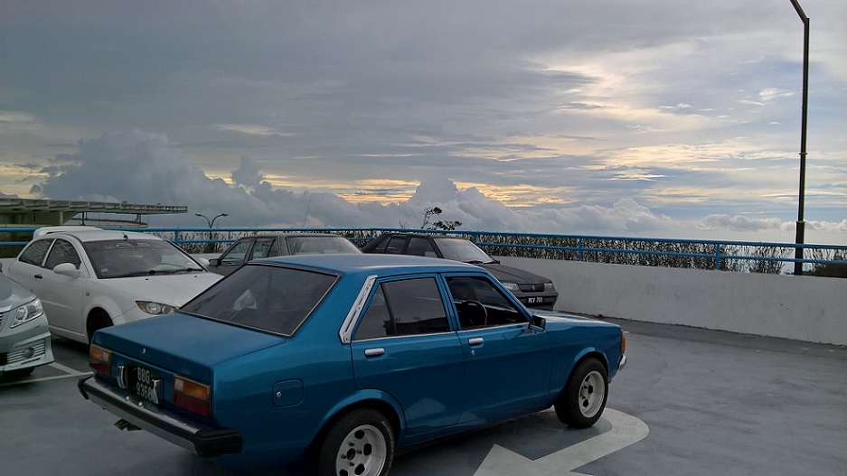

1st trip to Genting Highland, Malaysia(1740 meter) with my datsun. I can say it was an effortless steady hill climbing. should i thank the 4.11 diff?
On the other hand, there is no sudden acceleration if i floor the gas pedal. But better result if i slowly press the pedal along with the engine rev.
Does it mean i need a thicker SU damper oil?

Nice photos. What brand are your wheels?
Sounds like it might be bogging down. I would use the recommended 20W or 10W-30 engine oil in the carburetors
Are they L-series carburetors? If so the needle jet might be too rich, you can try raising the needle by turning the idle adjusting nut in 1/2 turn. Just going from sea level to high elevation will make the carburetor run poorly but a quick adjustment along the way will fix it

Thanks. Those are believed to be Performance Spitfire.
But with only stamp 'made in Australia'
13x7"
Yes its L carburetor with ATF as damper oil

You might need to raise the needle a full turn. Try it at half turns and see
Best to replace the L-series needle with A-series needle, and A-series spring. I've heard that AFT is similar in viscosity to the recommended oil

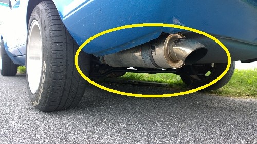

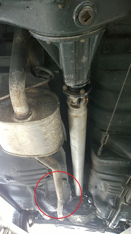

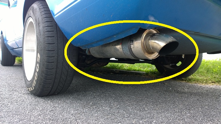

quick undercarriage wash. managed to snap some exhaust photos.
I went to 2 exhaust shops. one ask me to add a center muffler at the cat-converter place (red circle) and remove the sports muffler (yellow circle).
Another shop ask me to just replace the sports muffler to a largest standart muffler as possible.
i want quiet exhaust sound and high flow.
