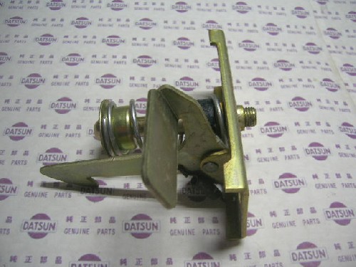

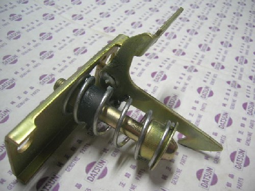

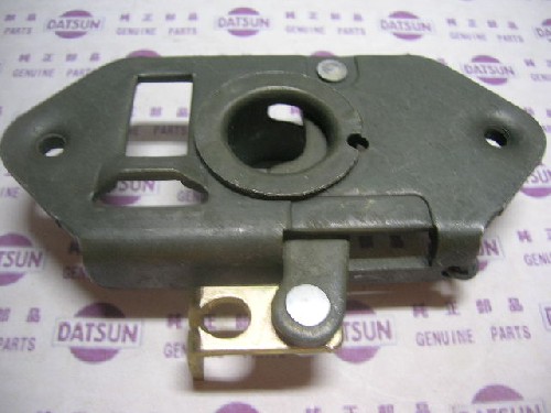

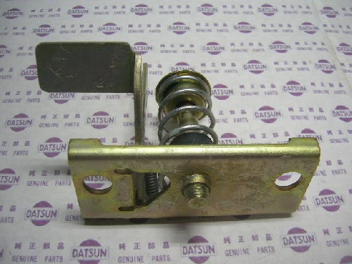

Ex-factory I believe both silver and gold on different parts:
and this may not be ex-factory, but is OEM replacement

Here's another look. Bprojects is currently selling this genuine Nissan bonnet latch for B110. Finish seems different from my original 1972
