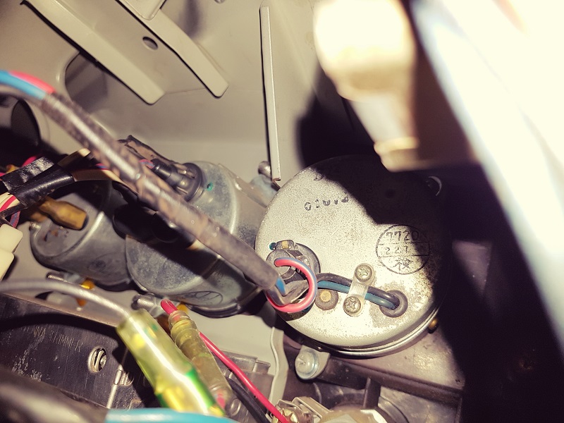

I wonder if you use could use the ordinary harness? The main cluster and tach should be fine.
Then make a little connector from the clock plug to share with the Amp/Volt meter, and the oil gauge. Then just add a wire from the oil pressure sender to the oil gauge. The Amp meter has extra white and white/red wires. The volt meter just has one plug like the clock.
I have the dash and all gauges just no harness.
Posted on: 2019/10/16 9:00
Re: B210 Round Gauge Dash Electrics
Posts: 31754
Sounds do-able
If you modify the stock harness to work with autometer gauges it should work with Nissan
Posted on: 2019/10/18 8:45
Posts: 31754
Meant to say ... if you CAN modify a stock wiring harness to work with aftermarket gauges like Autometer gauges -- which is done all the time -- then you should be able to make it work with Nissan gauges
