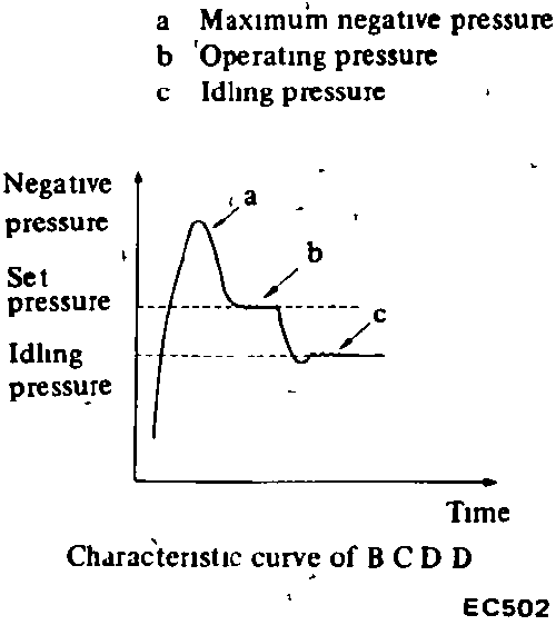

3. If B.C.D.D. is in good condition, vacuum gauge will indicate the following phenomena
a. It will suddenly rise up to about 600mmHg
b. It will decrease gradually to 560mmHg and stay there for a while
c. It will drop to idle boost pulse
Figure EC-25 Characteristic curve of B.C.D.D.

When operating pressure is too high, B.C.D.D. remains inoperative and negative pressure decreases with no sustained plateaus while it is falling. See diagram (A). In such a case, adjust operating pressure as follow:
Figure EC-26 Characteristic curve (high operating pressure)
<< Low operating pressure >>
When operating pressure is too low, engine rpm will not fall to idle speed
Figure EC-27 Characteristic curve (low operating pressure)

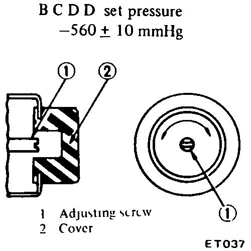

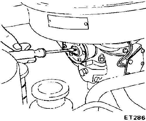

1. Remove rubber cap at bottom of B.C.D.D.
2. Turn adusting screw slightly. Then, race engine and confirm that operating pressure is at the specified value
Figure EC-28 Adjusting control valve
Figure EC-29 Adjusting setscrew
Notes:
a. Turning adjusting screw one quarter rotation will cause a change in operation pressure of about 20mmHg
b. Do not fit tip of screwdriver tightly into screw slot

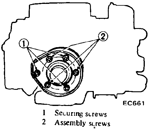

The first doubles as the "gasket" to bolt onto the carburetor, it is actually a vacuum diaphragm that moves the inlet passage ball valve. The other one is between the two housing halves, and i think moves slightly when the adjuster is turned
To remove the BCDD take the screw on the pointed end, and the other two screws (marked '1' in the diagram)
If you remove all the screws the adjustment screw plate can come free. The diaphragms don't always tear, can sometimes be reused. Does the Tomco kit come with new diaphragms?
