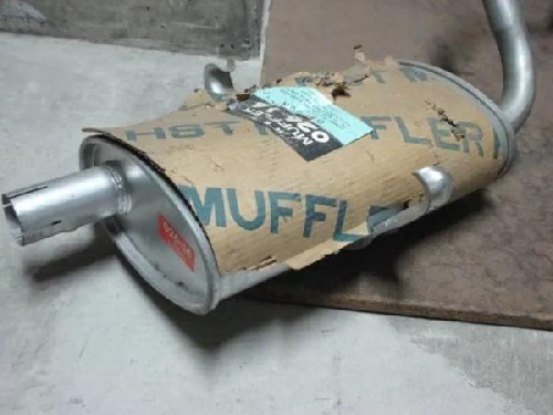

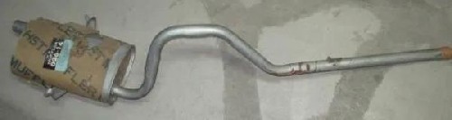

It's getting near impossible to find a replacement exhaust
New Old Stock (NOS) genuine Datsun muffler
Original mufflers came with integrated exhaust pipe - Top one is an aftermarket multi-piece type
Sedan/Coupe/Wagon differ
120Y muffler has a more severe upsweep but might fit the B110

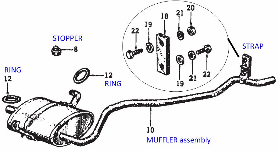

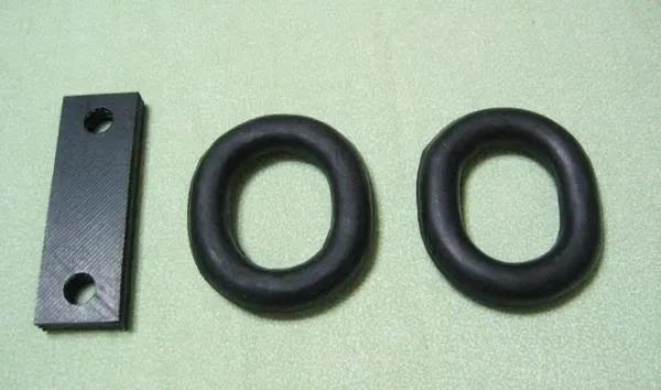

These factory parts make your exhaust absolutely quiet. With an original muffler, you couldn't hear the engine idling
Google search and japanese search
The muffler clamp RINGs and the hanging STRAP take all the vibrations out. Generic versions of these parts work OK
The rubber hangers have B10 Datsun 1000 part numbers
26030-18001 RING-rubber, muffler clamp
Early B210 to 1975 (including 120Y) looks the same, but as usual has an H50 part type, so they may be slightly different. Oh, by the way, when you get new ones, they seem too small. But they stretch to fit
26030-H5000 RING-rubber, muffler clamp 30x39mm inside diameter, 13mm diameter
Datsun 910/S110 Silvia and Nissan R30 Skyline/C31 use similar rings, but they are thicker (15 mm). Nissan 20630-N8200
Buy at Bprojects or https://datsun1200.jp
The strap (rectangular) rubber hanger uses M8 bolts and washers. It would be easy to make one, with some kind of heat-resistent material: 90x30x12mm with 2 M8 holes on 60mm centers. Or get one off a 280ZX, 810 Maxima, Urvan, Vanette, 240Z or 510/610/710 20640-18000

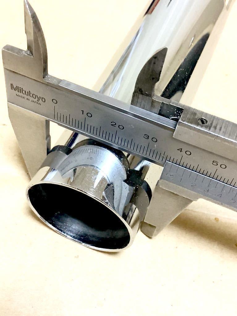

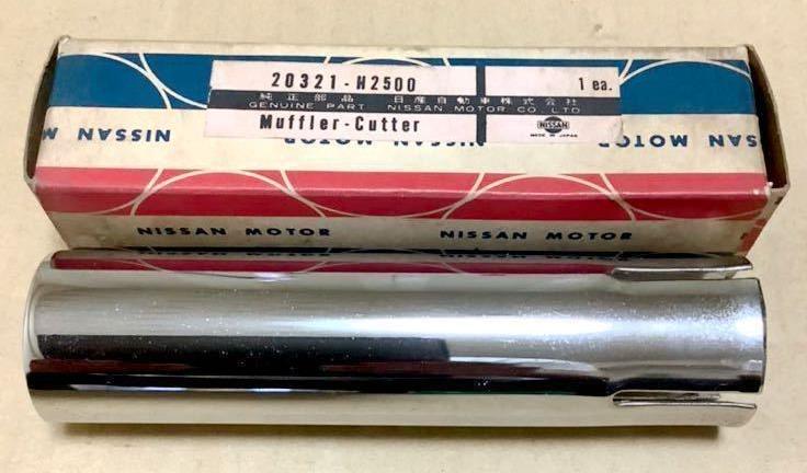

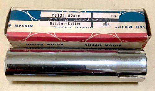

Exhaust tip
Posts: 31839

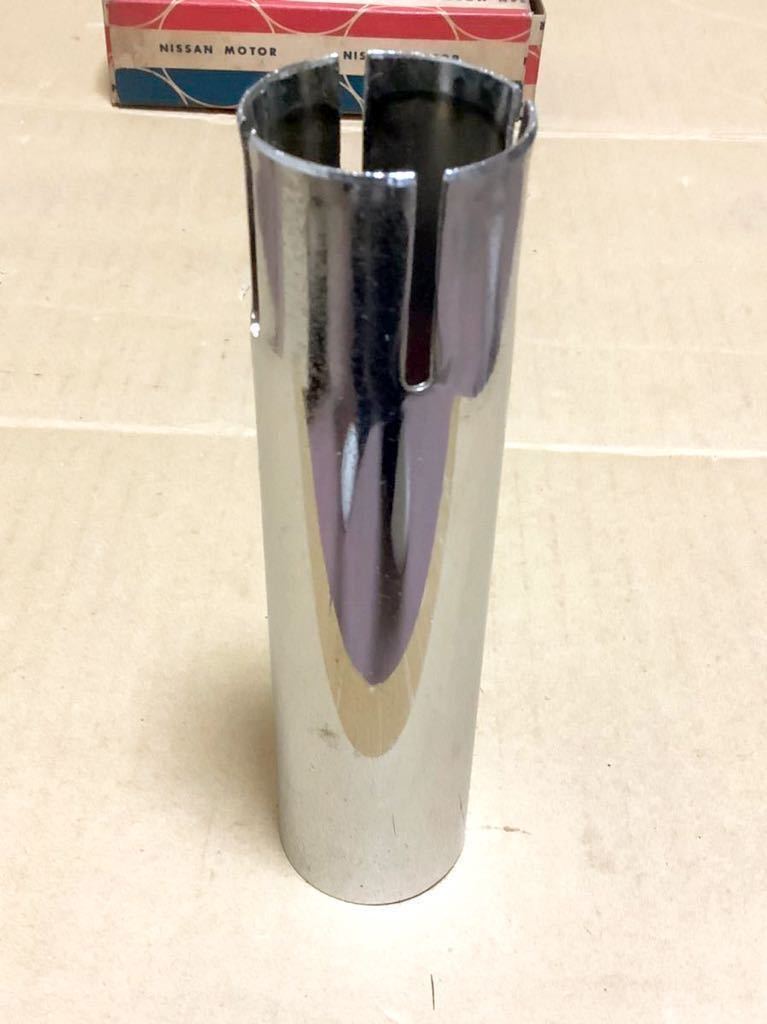

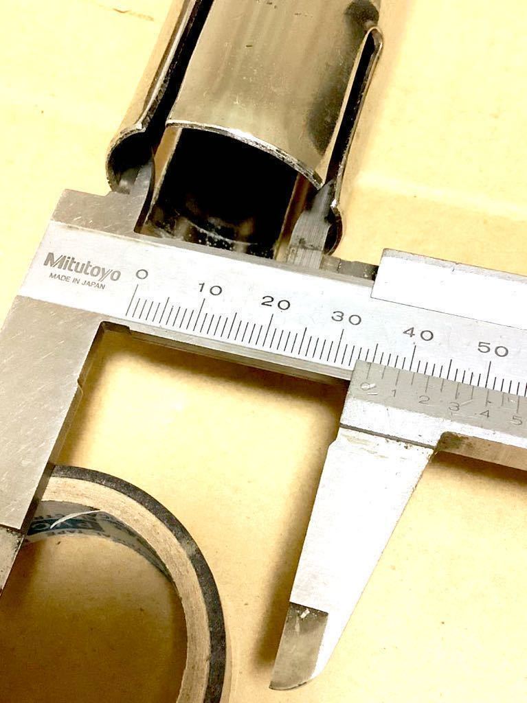

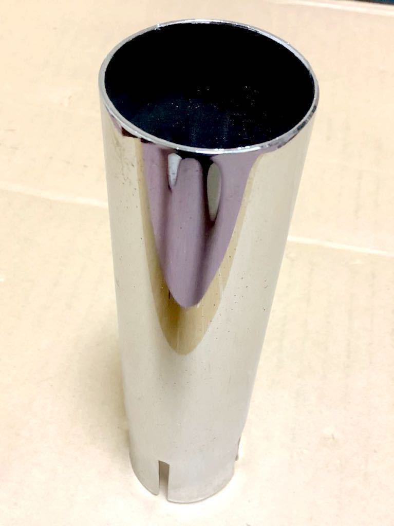

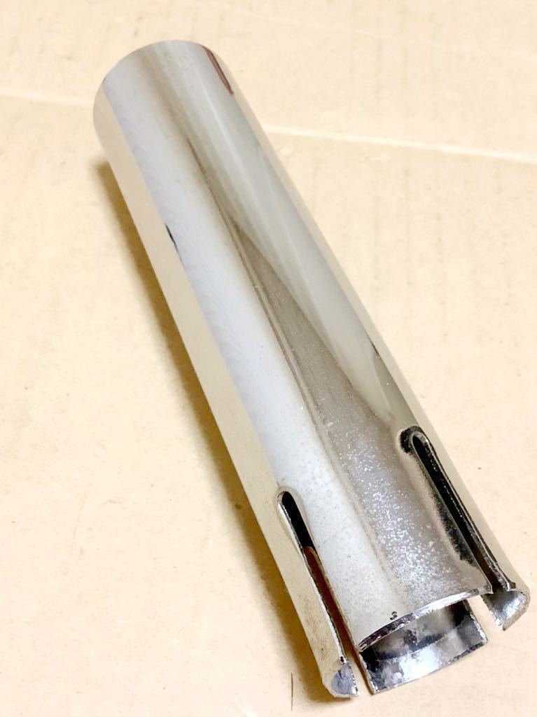

For sharp looks, you can fit a stainless extension which looks good forever. Needs to fit a 1.5 inch pipe, and while most aftermarket tips are larger they fit a range of smaller pipe sizes
or a cheaper chrome tip like this factory B110/B210 option, which looks fabulous for a few years
This is a vintage Nissan Muffler Cutter with part number 20321-H2500. It is a new old stock (NOS) part, meaning it is an original, unused part from a past production run.
* This type of part is often sought after by collectors and restorers of classic Datsun and Nissan vehicles.
* The packaging indicates it is a genuine Nissan part.
* The item is a chrome exhaust tip, designed to be fitted to the end of the tailpipe

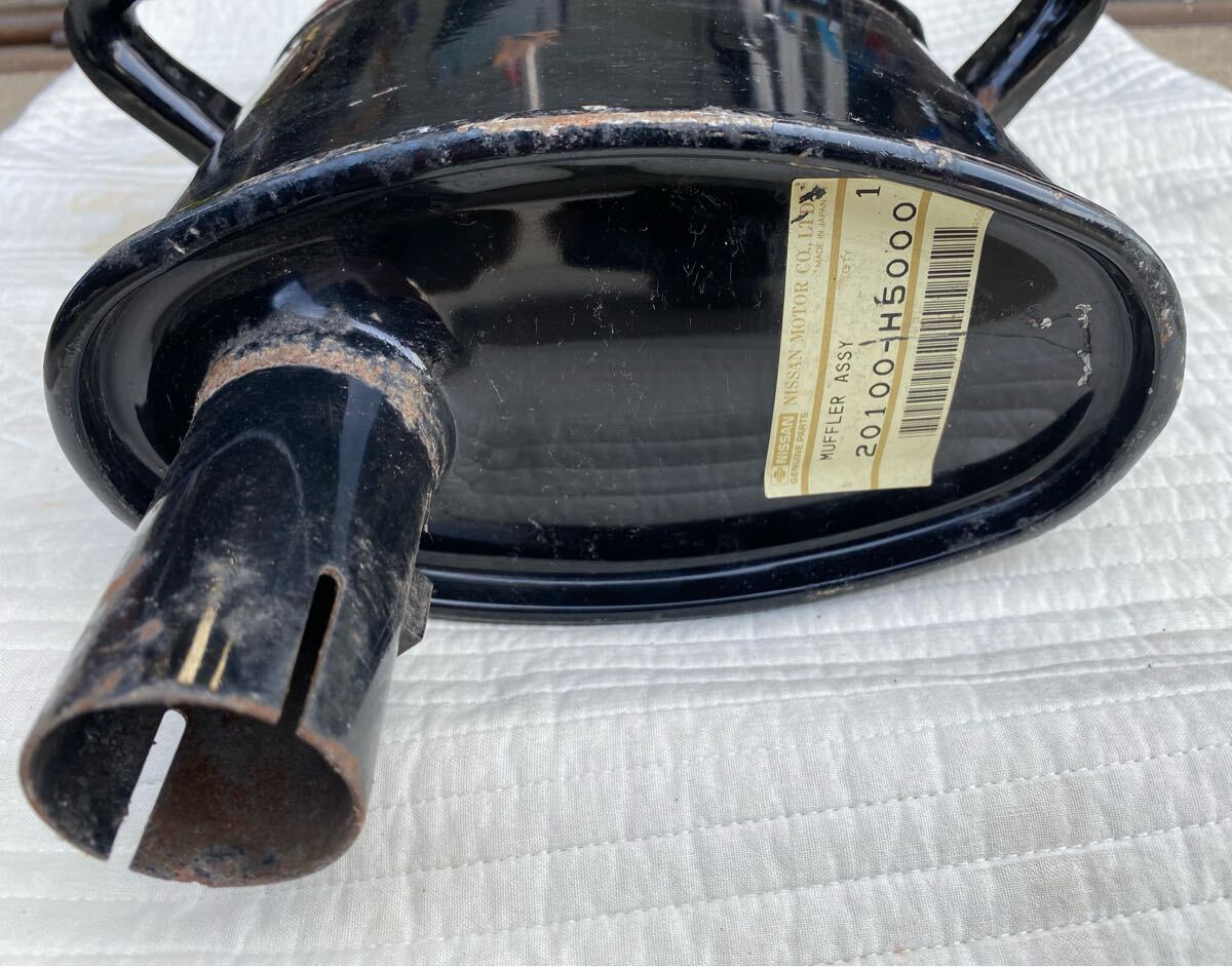

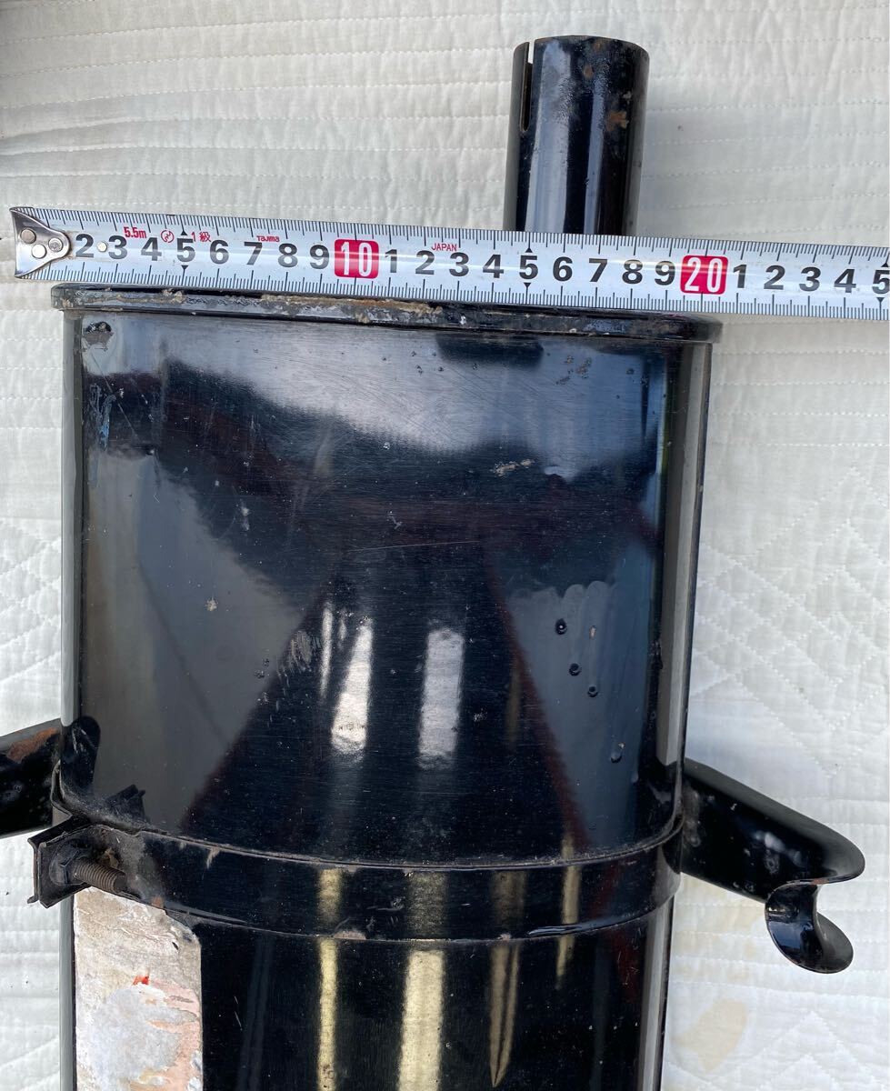

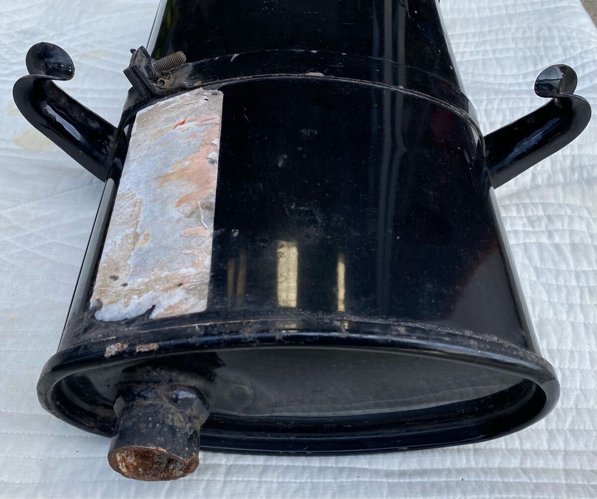

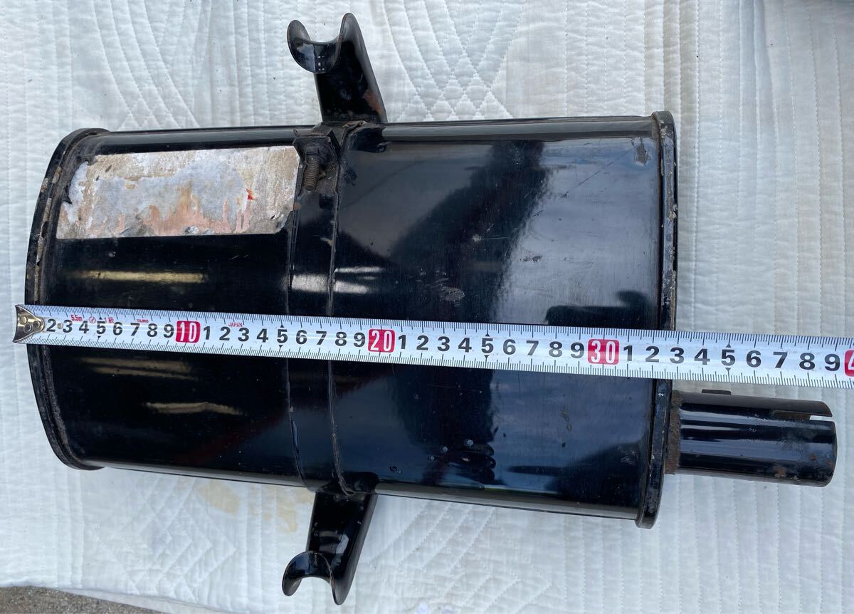

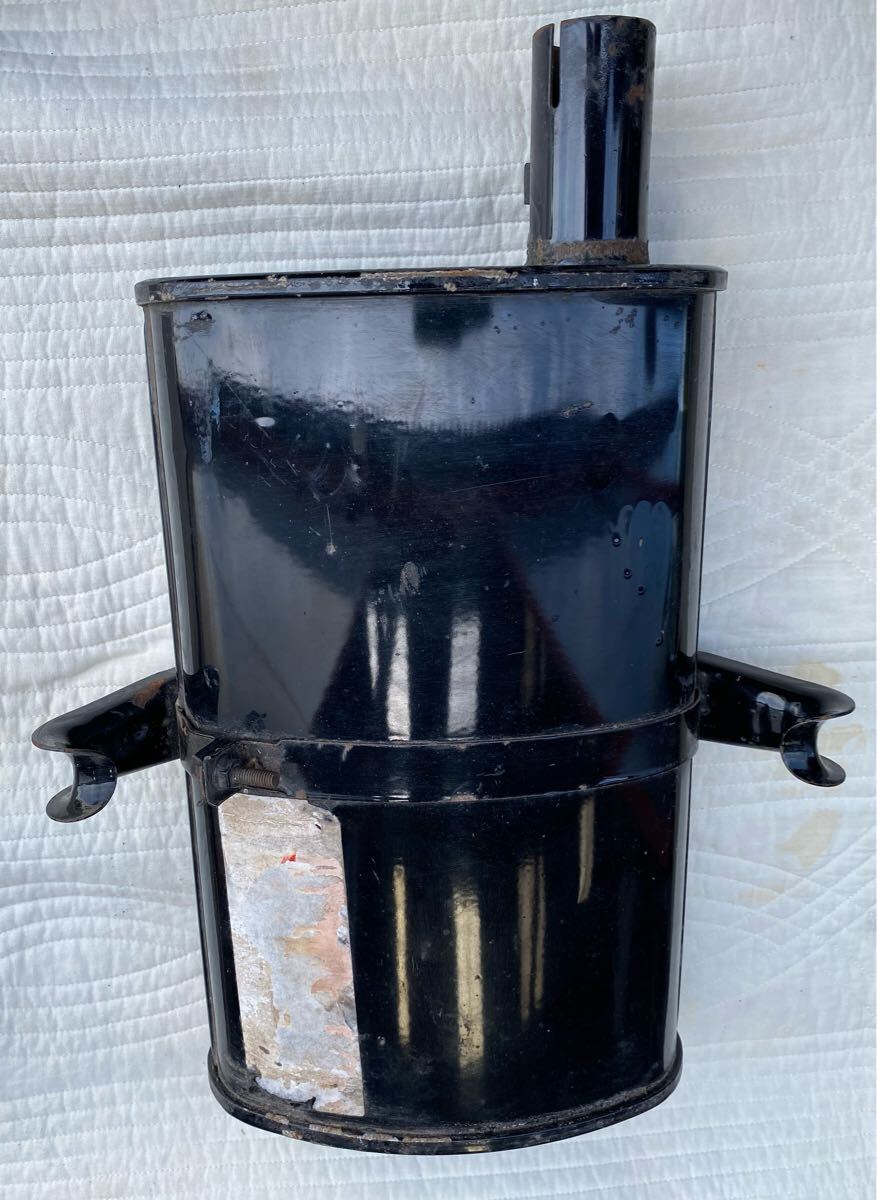

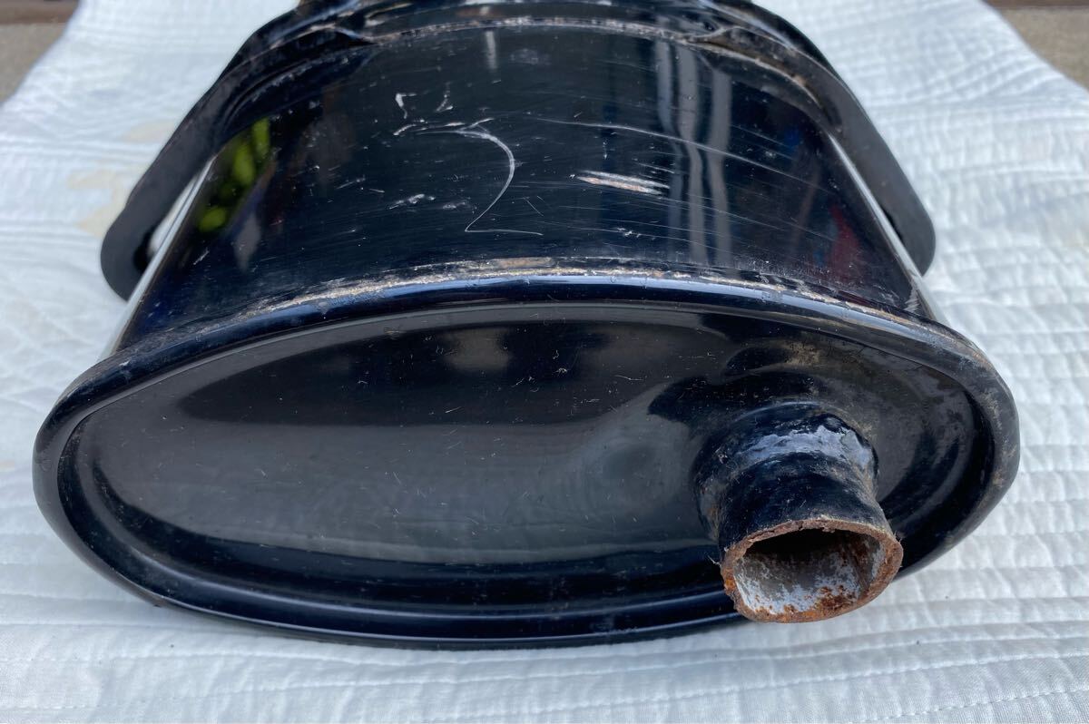

NOS muffler
Posts: 31839

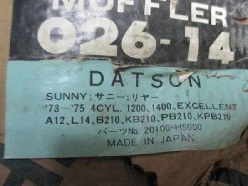

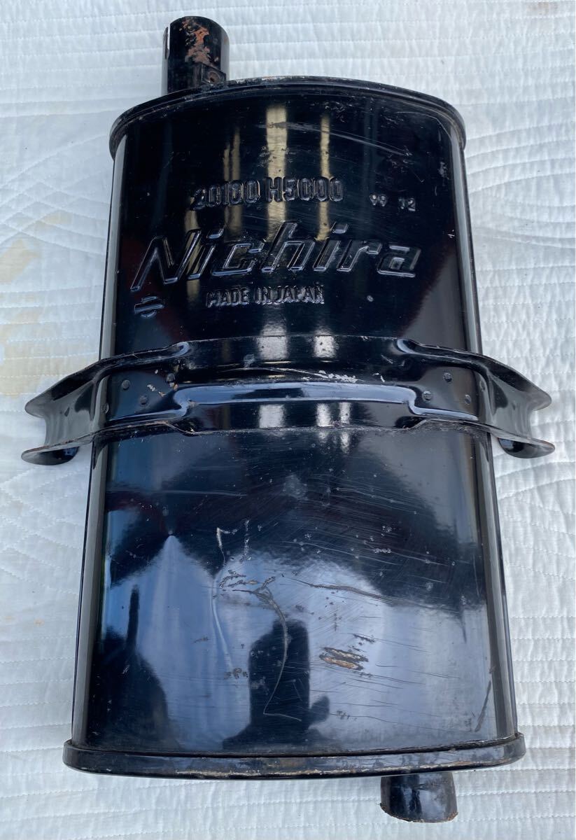

There was one genuine Datsun muffler for sale on Yahoo August 2025. It had 8 bids and sold for 34 USD
It is a B210 part number, and looks identical to the B110 part, but is a little longer at 329mm (1-3/8" longer than B110). There is plenty of room in a sedan for this. It (conveniently) has the tailpipe cut off for storage and shipping

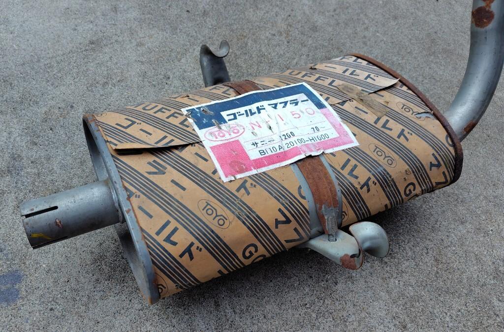

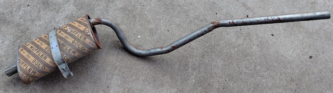

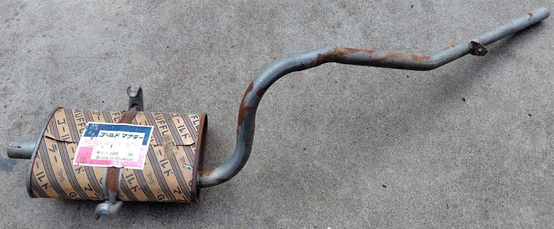

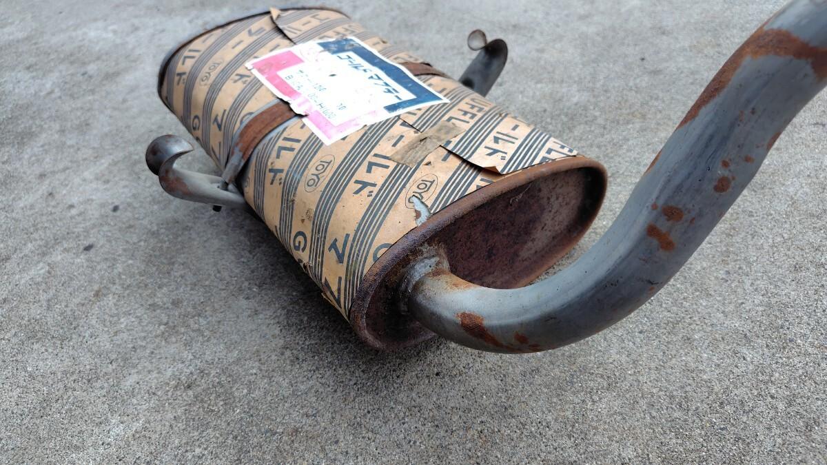

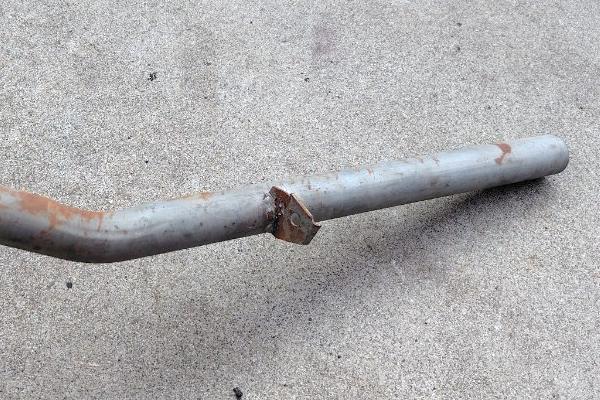

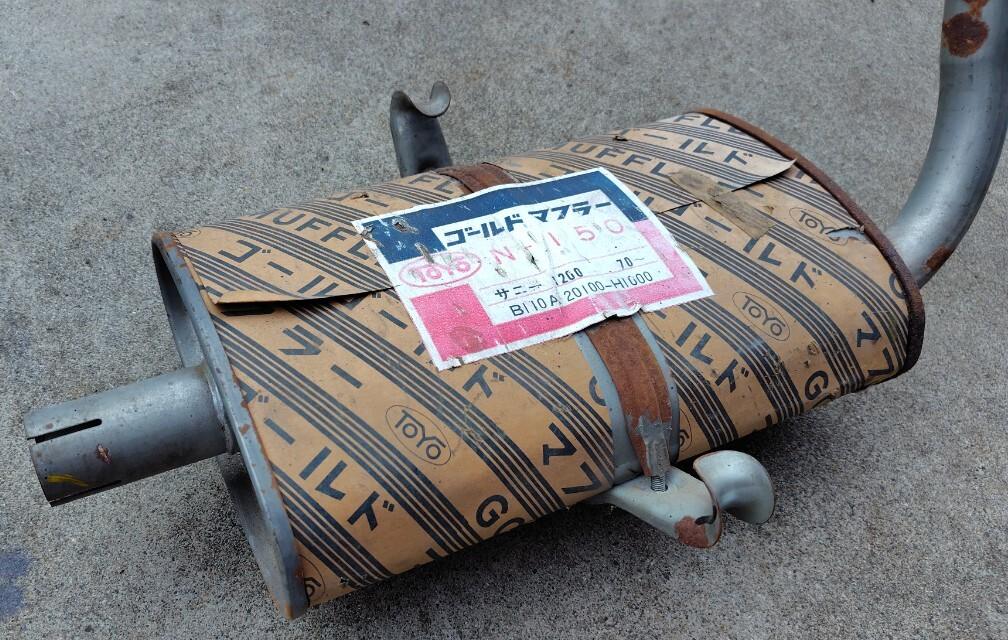

Re: NOS muffler
Posts: 31839
And here is another NOS (deadstock) muffler, this time an aftermarket (equivalent) part, a Toyo Gold muffler N-150. It was on Yahoo earlier this year and didn't sell at 32,000 Yen
The last one I bought was a well-used factory muffler, but it was still quieter than modern replacements ... and it fit perfect

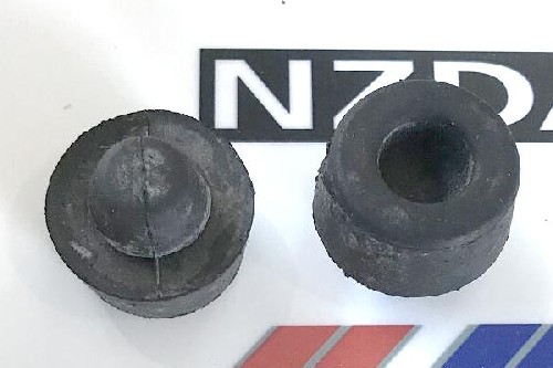

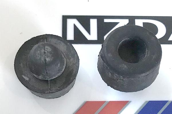

Muffler Stopper
Posts: 31839
Here's a factory piece I never noticed before. It prevents the muffler from banging against the floor
20635-18000 STOPPER-muffler
* B10 (all except earliest)
* B110
Early B210 to 1975 and all VB210 use the similar 610 bumper 20635-K0101
NZ Datsun Parts has this rubber bumper part for sale

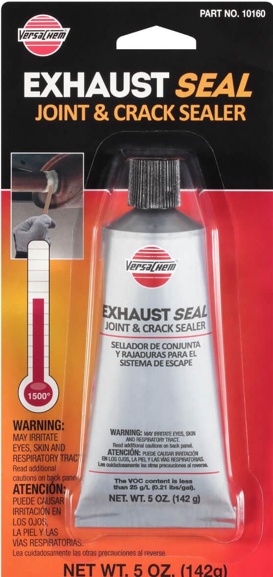

Connecting muffler to exhaust pipe
Posts: 31839

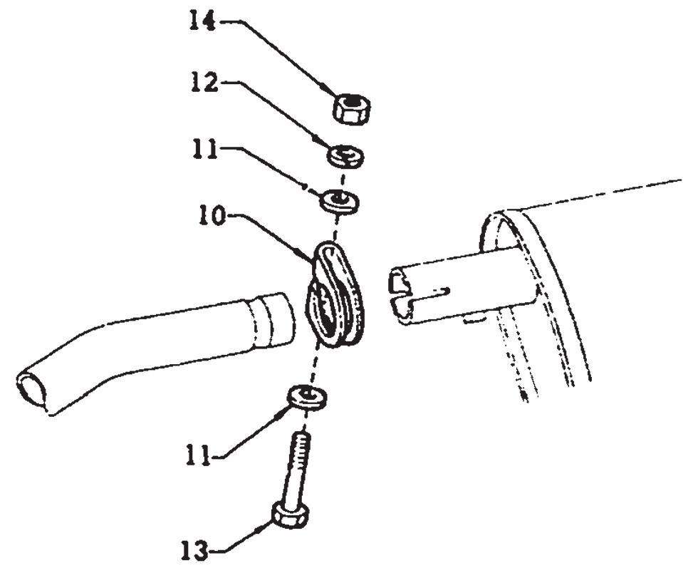

When it's time to fit the muffler to the exhaust pipe
The muffler input slips over the exhaust pipe coming from the manifold
This clamp tightens it down with an M8 bolt
20620-H1000 CLIP-tube, exhaust
replaced by
20643-B5000 CLAMP-exhaust tube (from 1973-11)
Because I didn't have the factory clip, I used a 1.5" muffler u-bolt
To make sure the exhaust seals, use the factory Datsun muffler seal in the exhaust pipe groove
20720-N2226 EXHAUST TUBE SEALANT
or a tube of generic muffler sealant:

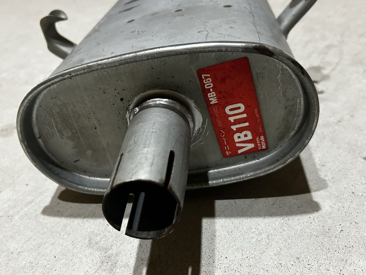

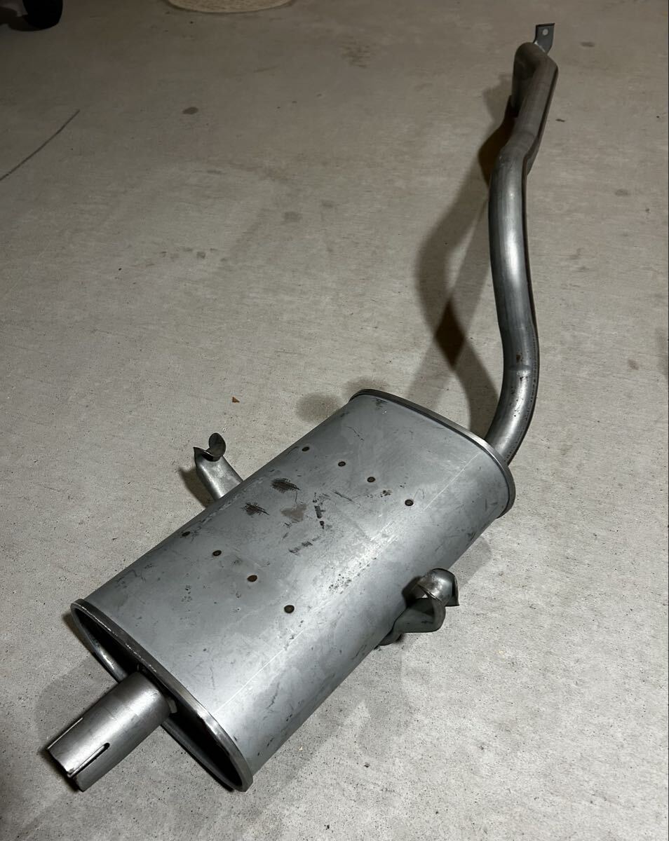

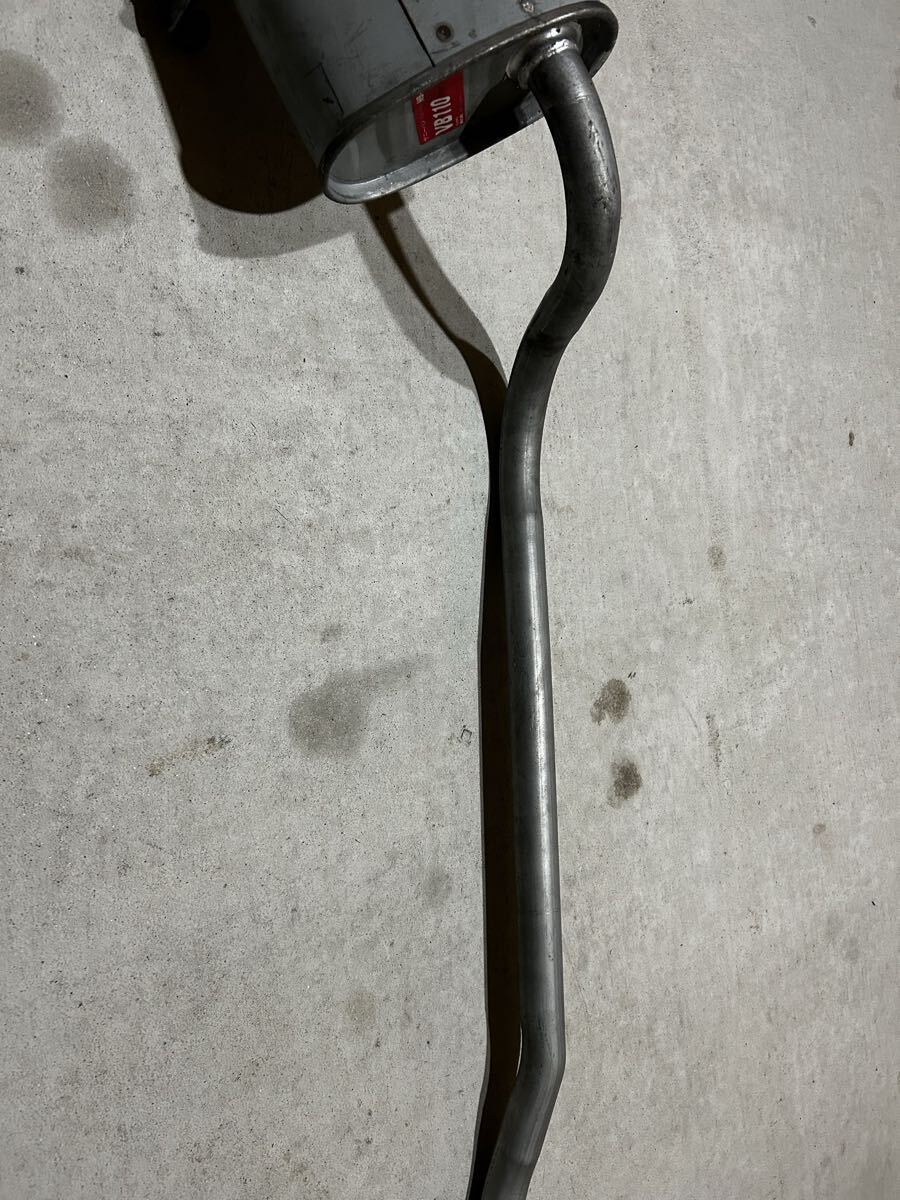

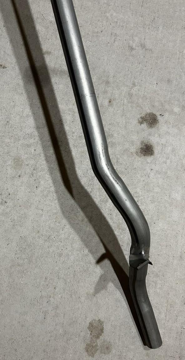

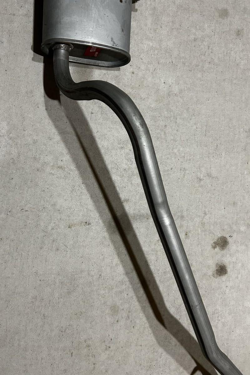

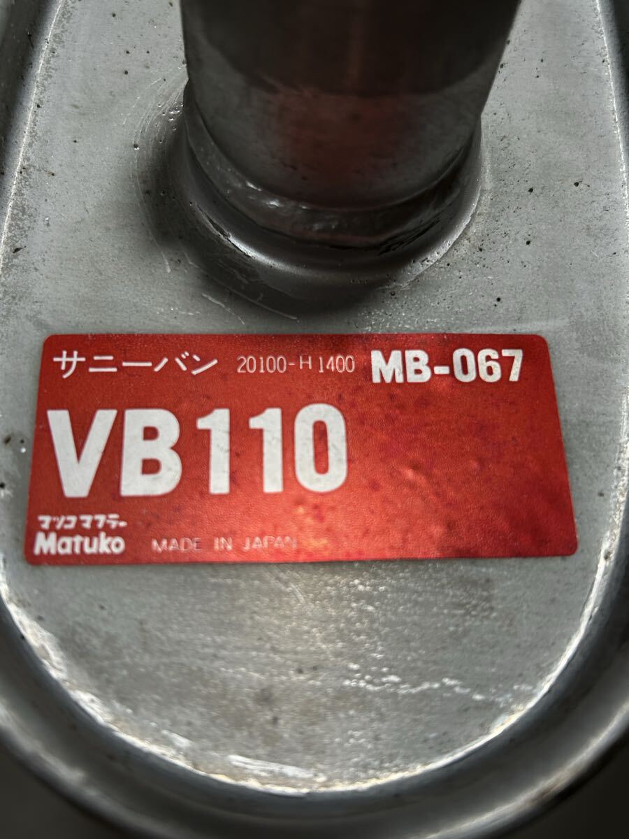

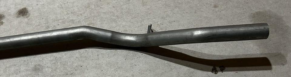

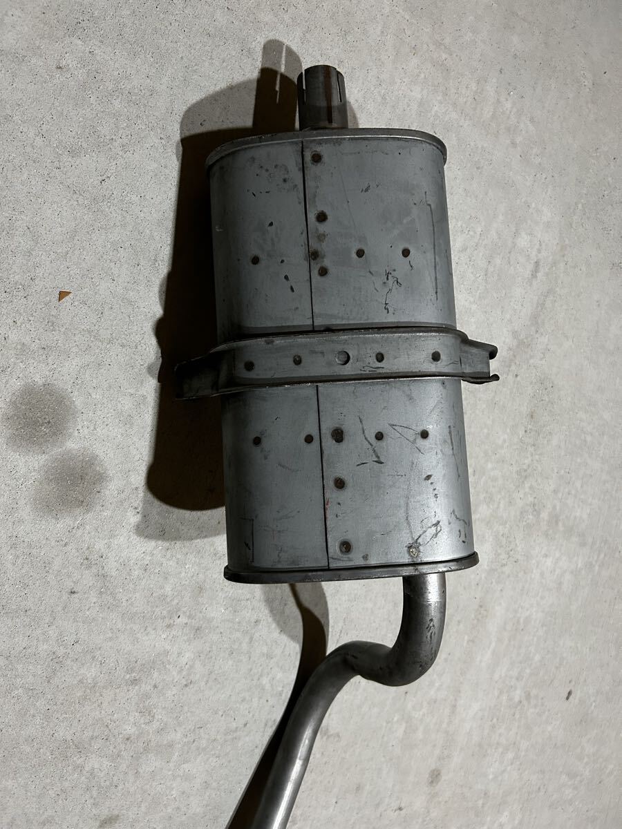

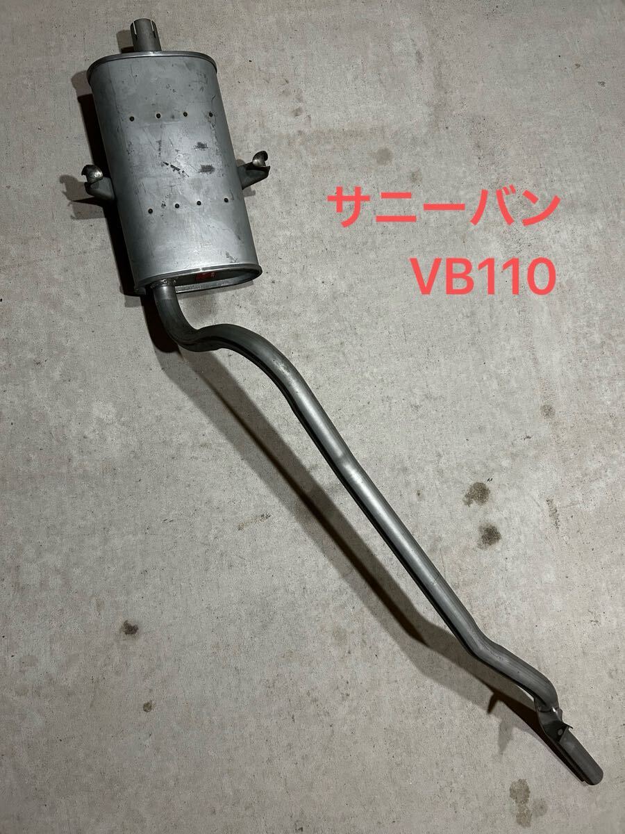

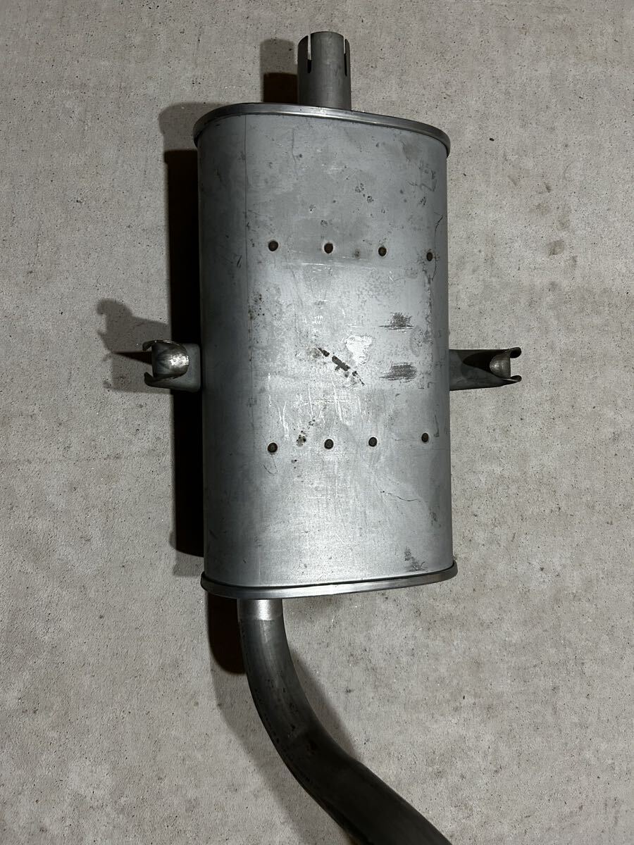

New 1200 wagon muffler
Posts: 31839
VB110 muffler sold on Yahoo for 84 AUD
It's a Matuko muffler. Matuko went out of business in 2017. Perhaps the last vendor of 1200-specific mufflers?
wagon/van has a kink near the rear hanger. Is that to clear the fuel tank filler hose?
