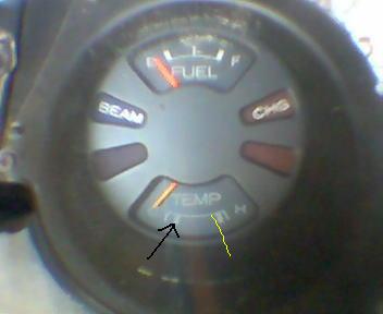

car started overheating
How did you determine that is was overheating? Did steam come out of the bonnet? Did the gauge needle go out of the middle range into the H area on the far,far right?
The engine can run all day close to the "H" mark. Just don't let it go over that.

Temp Gauge Went to H side and Sat Just Before H Mark Line,and i heard a noise from font Like "DOCK", "DOCK" felt that hot water was pressuring inside the water lines and my engine bay was extremely hot , but before it comes H Line i stopped the Car.
That's OK.
The engine bay should be extremely hot (82C/180F) is too hot to put your hand on it.

Just look at this picture (yellow Line) when needle comes to the Yellow Line Position i stopped the car, that time i can hear the dock dock sound from front, before thermostat installation it came to (Black indicator on the picture)in very rarely , it was lower than that even
