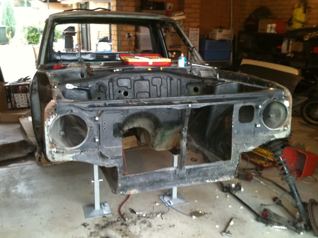

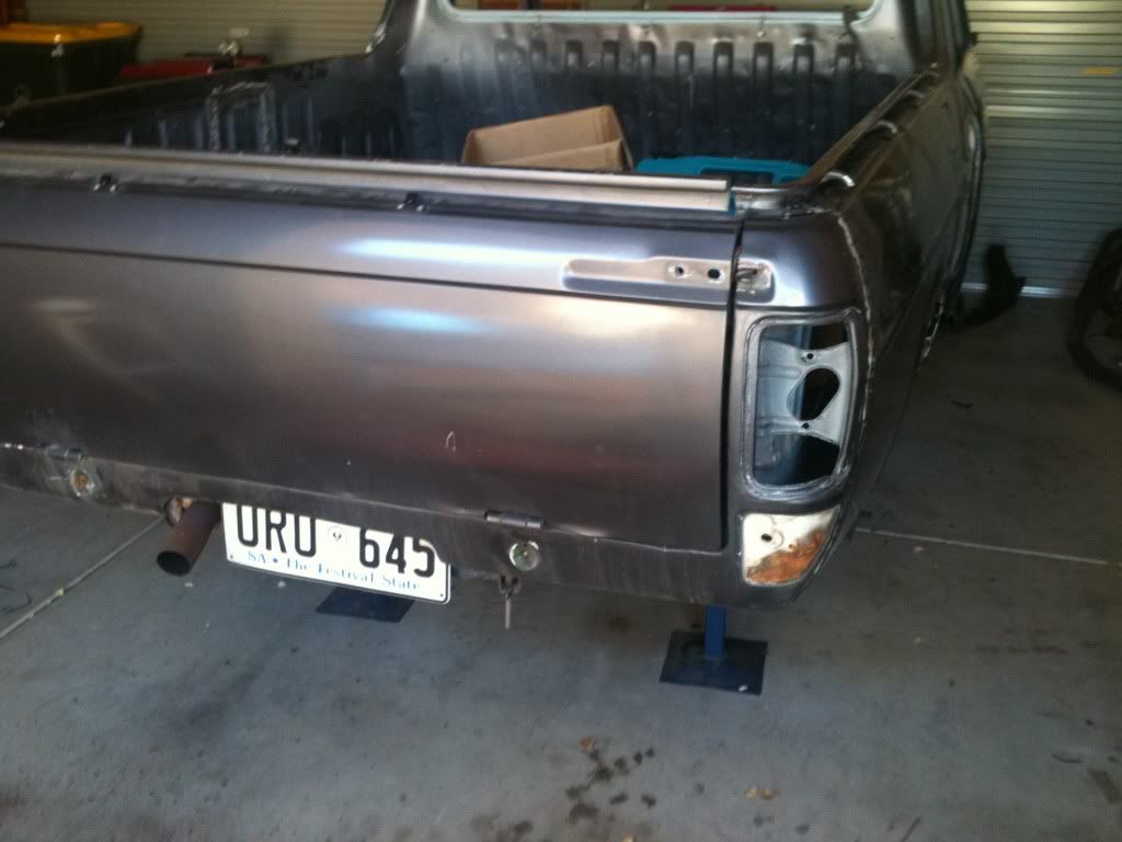

well for those of you that remember my ute it got defected so im starting again :(
so far i've stripped it down to almost nothing and am about to start some body work fixing whats left of the rust in it and also shaving everything on the back end. also going to paint it in the new VE commodore poison ivy green
the motors getting some work done as well. im going to be fitting EDIS ignition, tooth belt driving the supercharger, making custom extractors, a custom inlet manifold, im gonna make up a EFI manifold at some point.
