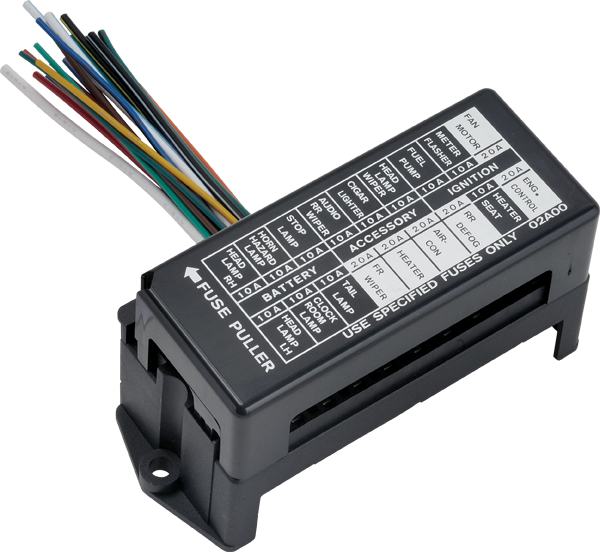

Re: Fuse Box Multiple Power Inputs
Posts: 31750
Check out Fuse Box
This is the one I was thinking about 16 fuse + spares. It is 1984 B11 Sunny/Sentra or maybe some other 1980s Nissan.
I dunno what connectors are on the back side, probably closer to stock than the aftermarket boxes. Either plug in or cut & solder.
Posted on: 2011/6/21 7:58
Posts: 31750
OK that is the B11 box, i found photo of the cover
it is actually an 18 fuse box.
It is split into three: BATTERY, IGN and ACCESSORY
jpg  24310-02A00_.jpg (51.16 KB)
174_4e00447a1914b.jpg 600X552 px
